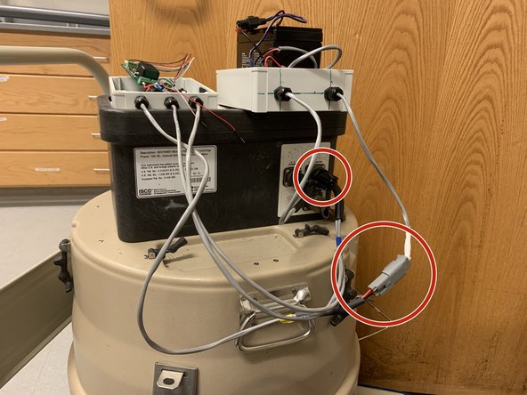

  2. Autosampler Node Troubleshooting (For New & Old Versions), Disconnect batteries completely.: crwdns2935265:02crwdnd2935265:01crwdnd2935265:03crwdne2935265:0 Autosampler Node Troubleshooting (For New & Old Versions), Disconnect batteries completely.: crwdns2935265:02crwdnd2935265:02crwdnd2935265:03crwdne2935265:0 Autosampler Node Troubleshooting (For New & Old Versions), Disconnect batteries completely.: crwdns2935265:02crwdnd2935265:03crwdnd2935265:03crwdne2935265:0
    • 3. Disconnect the plug to the solar panel.
    • Then, grabbing the green connector, pull the battery connector from the solar charge controller.
    • 4. Disconnect the plugs for the autosampler battery.
    • 5. Disconnect the connector that plugs into the battery port of the sampler.
    • If disconnect battery before solar panel, this can damage the solar charger!

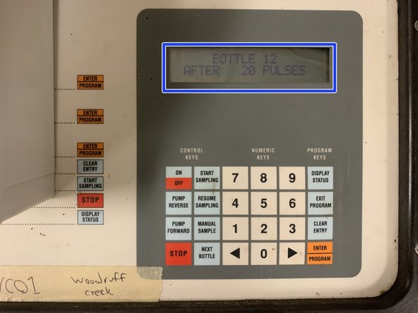

  6. Autosampler Node Troubleshooting (For New & Old Versions), Trigger autosampler with 6-pin connector: crwdns2935265:06crwdnd2935265:01crwdnd2935265:03crwdne2935265:0 Autosampler Node Troubleshooting (For New & Old Versions), Trigger autosampler with 6-pin connector: crwdns2935265:06crwdnd2935265:02crwdnd2935265:03crwdne2935265:0 Autosampler Node Troubleshooting (For New & Old Versions), Trigger autosampler with 6-pin connector: crwdns2935265:06crwdnd2935265:03crwdnd2935265:03crwdne2935265:0
    • Set the sample bottle to 12 for easier verification. And then press Enter.
    • Screen should say "Bottle 12 After 20 Pulses"

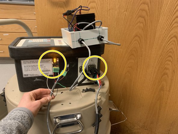

    • Plug in the 6-pin connector to the autosampler. The yellow LED should light up immediately.
  7. Autosampler Node Troubleshooting (For New & Old Versions), Trigger autosampler with 6-pin connector: crwdns2935265:07crwdnd2935265:01crwdnd2935265:03crwdne2935265:0 Autosampler Node Troubleshooting (For New & Old Versions), Trigger autosampler with 6-pin connector: crwdns2935265:07crwdnd2935265:02crwdnd2935265:03crwdne2935265:0 Autosampler Node Troubleshooting (For New & Old Versions), Trigger autosampler with 6-pin connector: crwdns2935265:07crwdnd2935265:03crwdnd2935265:03crwdne2935265:0
    • Touch the jumper wire to the LED attached to the white wire 20 times. This wire is for sending pulses to the autosampler.
    • You will see the pulse count decreasing on the LCD screen.
    • You will hear the autosampler making noises as it moves to bottle 12. You will then see the green LED flash 12 times to indicate the 12th bottle.

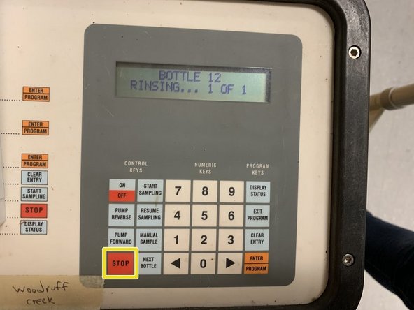

  8. Autosampler Node Troubleshooting (For New & Old Versions), Trigger autosampler with 6-pin connector: crwdns2935265:08crwdnd2935265:01crwdnd2935265:01crwdne2935265:0
    • You will see the LCD start indicating the sampling steps. Press Stop.
    • If these steps work as outlined, you have successfully tested the autosampler with the 6-pin connector and the autosampler is working correctly.
    • If the LEDs did not work or the sampler does not start the sampling process, something may be wrong with the autosampler wiring.
