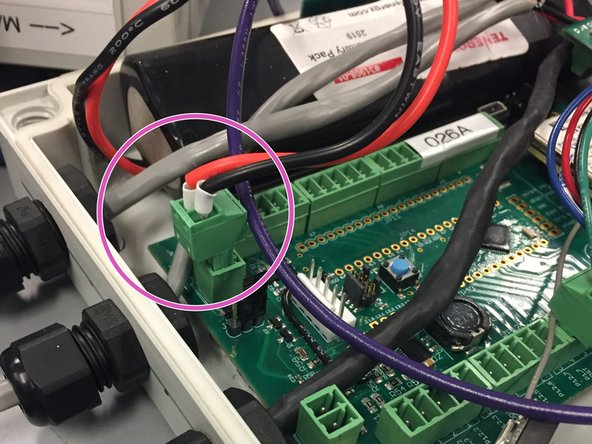

    • Take the two wires from the 2-pin female amphenol battery box connector and screw them into the board.
    • Screw the red power wire into the topmost terminal on the bottom 6-pin connector.
    • Screw the black ground wire into the terminal directly below the red wire.
    • Ensure that the exposed copper portions of the wire are secure and do not touch.
  11. Autosampler Battery and Node Enclosure Assembly (2021), Attach the 2-pin Sampler Wires to the Board: crwdns2935265:011crwdnd2935265:01crwdnd2935265:03crwdne2935265:0 Autosampler Battery and Node Enclosure Assembly (2021), Attach the 2-pin Sampler Wires to the Board: crwdns2935265:011crwdnd2935265:02crwdnd2935265:03crwdne2935265:0 Autosampler Battery and Node Enclosure Assembly (2021), Attach the 2-pin Sampler Wires to the Board: crwdns2935265:011crwdnd2935265:03crwdnd2935265:03crwdne2935265:0
    • Screw the red power and black ground wires into the board from the 2-pin amphenol connector that attaches directly to the sampler.
    • Screw the black ground wire into the terminal 2 up from the bottom terminal of the top connector.
    • Screw the red power wire into the terminal 1 up from the bottom of the bottom connector.
  12. Autosampler Battery and Node Enclosure Assembly (2021), Attach the Wires from the 6-pin Connector to the Board: crwdns2935265:012crwdnd2935265:01crwdnd2935265:03crwdne2935265:0 Autosampler Battery and Node Enclosure Assembly (2021), Attach the Wires from the 6-pin Connector to the Board: crwdns2935265:012crwdnd2935265:02crwdnd2935265:03crwdne2935265:0 Autosampler Battery and Node Enclosure Assembly (2021), Attach the Wires from the 6-pin Connector to the Board: crwdns2935265:012crwdnd2935265:03crwdnd2935265:03crwdne2935265:0
    • Attach the blue, green, and brown wires from the 6-pin connector to the board. These wires have been fed through the box previously and are heat shrink wrapped.
    • Screw the green wire into the topmost terminal on the top connector.
    • Screw the blue wire into the terminal directly below the green wire
    • Screw the brown wire into the terminal directly below the black wire on the top connector.

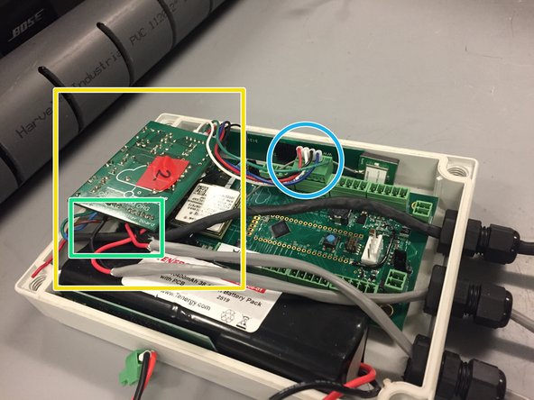

  13. Autosampler Battery and Node Enclosure Assembly (2021), Fit the boards into the node box: crwdns2935265:013crwdnd2935265:01crwdnd2935265:03crwdne2935265:0 Autosampler Battery and Node Enclosure Assembly (2021), Fit the boards into the node box: crwdns2935265:013crwdnd2935265:02crwdnd2935265:03crwdne2935265:0 Autosampler Battery and Node Enclosure Assembly (2021), Fit the boards into the node box: crwdns2935265:013crwdnd2935265:03crwdnd2935265:03crwdne2935265:0
    • Slide the open storm board into the node box on the right pushed up as close to the ports as possible.
    • Slide the 3-4V battery into the enclosure on the left side.
    • Carefully fold the connected relay board over so that it fits within the enclosure snuggly.
    • Check to make sure that the connections remained secure.
    • Plug the 6 pin connector into the port on the open storm board that is the second from the left side of the board in the image near the SD card port.
    • Check that the battery port is exposed for deployment, but do not plug in the battery until the sampler is ready to begin sampling.
