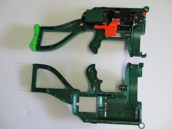

    1. Automatic Tommy 20 Trigger Spring Replacement, Split the Gun into Two Halves: crwdns2935265:05crwdnd2935265:01crwdnd2935265:02crwdne2935265:0 Automatic Tommy 20 Trigger Spring Replacement, Split the Gun into Two Halves: crwdns2935265:05crwdnd2935265:02crwdnd2935265:02crwdne2935265:0
      • Grab both sides of the gun and pull forcefully in an upward and outward motion to remove from the light green stock.
      • If this is your first time disassembling your gun, the stock will be glued to each half of the gun's body. To break off the stock from the frame of the gun, you will need to careful wiggle the two halves so that the glue will break apart. The plastic on the gun may break or warp slightly.

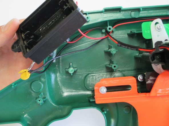

    2. Automatic Tommy 20 Trigger Spring Replacement, Removing the Battery Box: crwdns2935265:06crwdnd2935265:01crwdnd2935265:02crwdne2935265:0 Automatic Tommy 20 Trigger Spring Replacement, Removing the Battery Box: crwdns2935265:06crwdnd2935265:02crwdnd2935265:02crwdne2935265:0
      • Remove the two 1/16 in. screws attaching the battery box to the frame of the gun using a Phillips #00 Screwdriver.
      • Lift the battery box off the frame of the gun to give yourself access to the trigger mechanism.

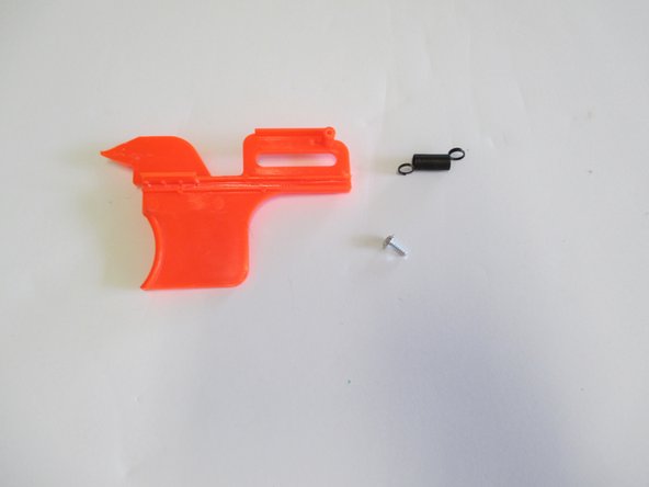

    3. Automatic Tommy 20 Trigger Spring Replacement, Removing the Screws from the Trigger Mechanism: crwdns2935265:07crwdnd2935265:01crwdnd2935265:01crwdne2935265:0
      • Remove the two 1/6 in. screws connecting the trigger and trigger spring to the frame of the gun using a Phillips #00 Screwdriver.
    4. Automatic Tommy 20 Trigger Spring Replacement: crwdns2935265:08crwdnd2935265:01crwdnd2935265:02crwdne2935265:0 Automatic Tommy 20 Trigger Spring Replacement: crwdns2935265:08crwdnd2935265:02crwdnd2935265:02crwdne2935265:0
      • Lift the plastic trigger away from the gun along with the attached spring.
      • Make sure you do not lift the trigger without the spring or the spring may stretch and no longer function properly.
