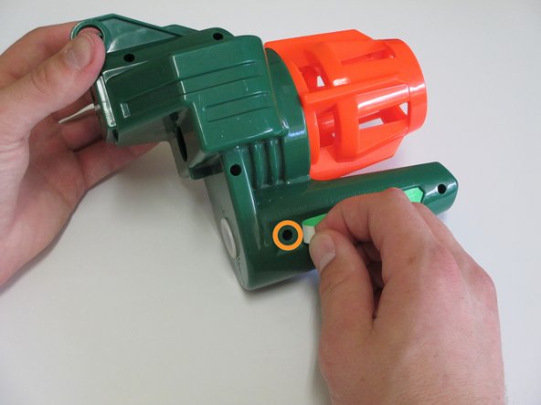

    • Locate the orange slider on the front side of the gun.
    • Pull the orange slider towards the back of the gun while lifting up on the nose the gun.
  2. Automatic Tommy 20 Ammo Drum Bushing Replacement: crwdns2935265:02crwdnd2935265:01crwdnd2935265:03crwdne2935265:0 Automatic Tommy 20 Ammo Drum Bushing Replacement: crwdns2935265:02crwdnd2935265:02crwdnd2935265:03crwdne2935265:0 Automatic Tommy 20 Ammo Drum Bushing Replacement: crwdns2935265:02crwdnd2935265:03crwdnd2935265:03crwdne2935265:0
    • Remove the single 1/8 in. screw at the junction of the body and the nose using a Philips #00 Screwdriver.
    • Remove all parts within the chamber to be able to completely detach the nose of the gun.
    • Be careful to keep track of all the components for reassembly.

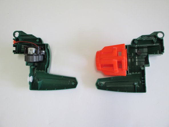

  3. Automatic Tommy 20 Ammo Drum Bushing Replacement, Disassembling the Nose of the Gun: crwdns2935265:03crwdnd2935265:01crwdnd2935265:03crwdne2935265:0 Automatic Tommy 20 Ammo Drum Bushing Replacement, Disassembling the Nose of the Gun: crwdns2935265:03crwdnd2935265:02crwdnd2935265:03crwdne2935265:0 Automatic Tommy 20 Ammo Drum Bushing Replacement, Disassembling the Nose of the Gun: crwdns2935265:03crwdnd2935265:03crwdnd2935265:03crwdne2935265:0
    • Remove all five 1/16 in. screws holding the nose of the gun together using a Phillips #00 screwdriver.
    • Look out for the hidden fifth screw behind the thin light green tape near the bushing itself. Peel the tape using your finger to gain access.
  4. Automatic Tommy 20 Ammo Drum Bushing Replacement, Removing the Bushing: crwdns2935265:04crwdnd2935265:01crwdnd2935265:01crwdne2935265:0
    • Pick up the now split half of the nose of the gun that does not still have the orange tip attached to it.
    • Remove the bushing by simply pulling it away from the plastic.
