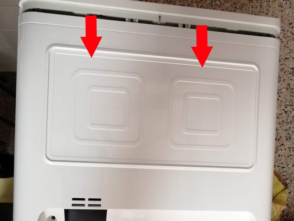

    • Using a T10 screwdriver, remove the eight screws located on the rear panel of the device (4 towards the bottom, and 4 towards the top).
