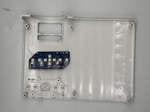

  3. Auking M8-F PCB Button Panel Replacement: crwdns2935265:03crwdnd2935265:01crwdnd2935265:02crwdne2935265:0 Auking M8-F PCB Button Panel Replacement: crwdns2935265:03crwdnd2935265:02crwdnd2935265:02crwdne2935265:0
    • Remove the wire cord attached to the top panel to separate both the top panel and the wire cord.

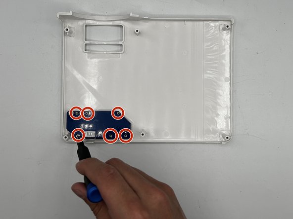

  4. Auking M8-F PCB Button Panel Replacement: crwdns2935265:04crwdnd2935265:01crwdnd2935265:03crwdne2935265:0 Auking M8-F PCB Button Panel Replacement: crwdns2935265:04crwdnd2935265:02crwdnd2935265:03crwdne2935265:0 Auking M8-F PCB Button Panel Replacement: crwdns2935265:04crwdnd2935265:03crwdnd2935265:03crwdne2935265:0
    • Remove six of the 5 mm screws using a Phillips #00 screwdriver to detach the power panel.
    • Remove the power panel.
