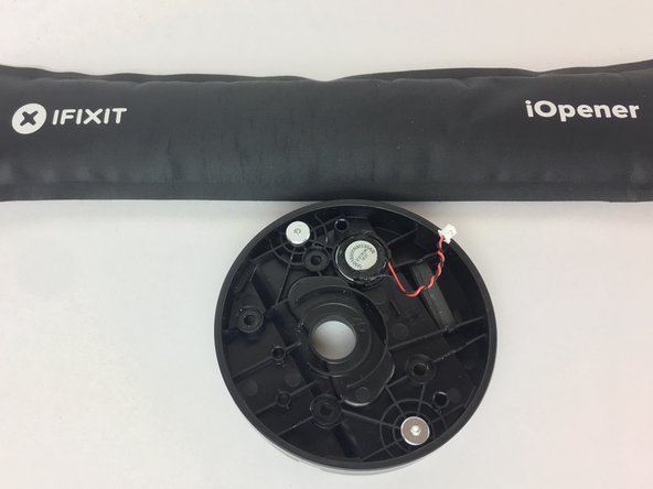

    • Warm up the iOpener.
    • Do not place the iOpener in microwave for more than 30 seconds.
    • Place the iOpener heating pad over the speaker and let sit for a few moments.

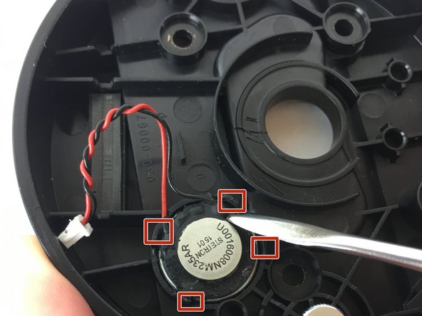

    • Using the metal spudger, pry some of the glue off the hinges holding the speaker in place.

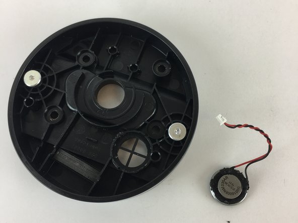

  4. August Smart Lock Speaker Replacement: crwdns2935265:04crwdnd2935265:01crwdnd2935265:02crwdne2935265:0 August Smart Lock Speaker Replacement: crwdns2935265:04crwdnd2935265:02crwdnd2935265:02crwdne2935265:0
    • Once the speaker looks mobile, flip the cover over and push below the speaker to pop it out.
