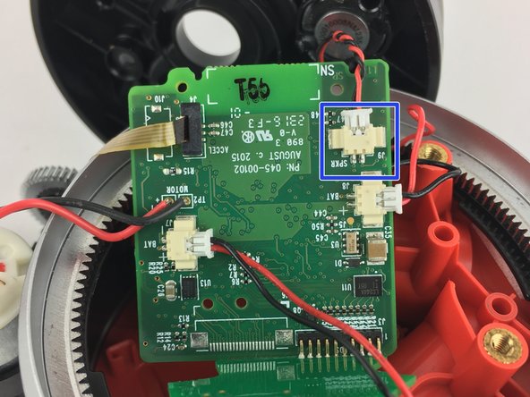

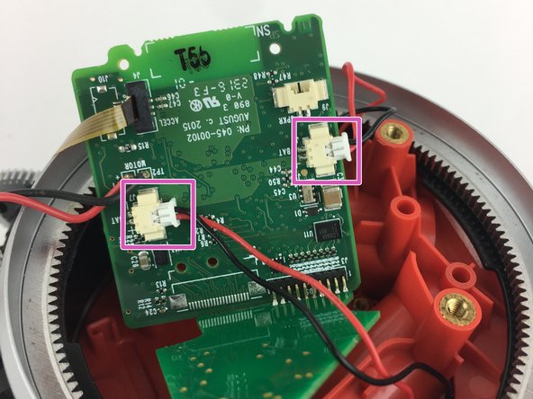

      • Remove the (3) three silver screws by the motor using a Phillips #0 screwdriver.
      • Disconnect the speaker plug from the motherboard
      • Disconnect the battery plugs from the motherboard.

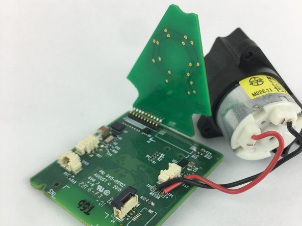

      • Locate the Accelerometer. It is attached to the motherboard by a ribbon.
      • Lift up the black tab to remove the ribbon from the motherboard.
