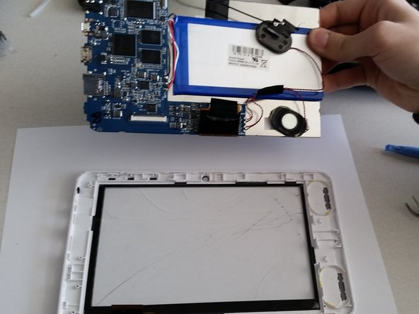

    • Find a good spot to fit the pry bar between the back cover and tablet. Slowly drag the pry bar along the sides of the cover.
    • NOTE: some force will need to be used to remove the cover. Avoid excessive force.
  2. Audiovox T752 Screen Replacement, Screen: crwdns2935265:02crwdnd2935265:01crwdnd2935265:01crwdne2935265:0
    • Remove the speakers.
  3. Audiovox T752 Screen Replacement: crwdns2935265:03crwdnd2935265:01crwdnd2935265:01crwdne2935265:0
    • Remove any adhesives (such as tape).
  4. Audiovox T752 Screen Replacement: crwdns2935265:04crwdnd2935265:01crwdnd2935265:02crwdne2935265:0 Audiovox T752 Screen Replacement: crwdns2935265:04crwdnd2935265:02crwdnd2935265:02crwdne2935265:0
    • Pry under the aluminum touch screen to remove the remaining components from the front housing.
