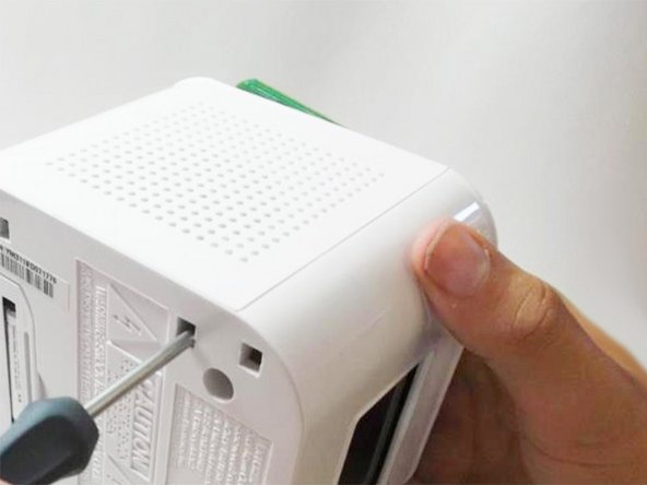

  7. Audiovox CR8030iE5 Speakers Replacement: crwdns2935265:07crwdnd2935265:01crwdnd2935265:02crwdne2935265:0 Audiovox CR8030iE5 Speakers Replacement: crwdns2935265:07crwdnd2935265:02crwdnd2935265:02crwdne2935265:0
    • Using your thumb, applying constant pressure, pull back the plastic tab towards the speaker and away from the metal bracket.
    • Simultaneously insert a Phillips #00 screwdriver into the square hole on the underside of clock and push through to lift the metal bracket off of the plastic tab.
