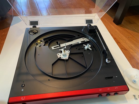

    • Remove the felt pad, and put it to the side.
  2. Audio-Technica LP60XBT Turntable Gear Replacement: crwdns2935265:02crwdnd2935265:01crwdnd2935265:01crwdne2935265:0
    • Turn the platter so that the brass motor pulley can be seen through one of the two outer holes in the platter.
    • If the drive belt is hooked around the motor pulley, unhook it.
    • When reassembling to device, don't forget to hook the new drive belt to the motor pulley.
  3. Audio-Technica LP60XBT Turntable Gear Replacement: crwdns2935265:03crwdnd2935265:01crwdnd2935265:02crwdne2935265:0 Audio-Technica LP60XBT Turntable Gear Replacement: crwdns2935265:03crwdnd2935265:02crwdnd2935265:02crwdne2935265:0
    • Remove the platter by grasping the platter by its two inner holes and lifting it upwards.
    • If the drive belt is unhooked and the tone arm is safely to the side, don’t be afraid to use a small amount of force in lifting the platter if necessary.
  4. Audio-Technica LP60XBT Turntable Gear Replacement: crwdns2935265:04crwdnd2935265:01crwdnd2935265:01crwdne2935265:0
    • Remove the four screws holding in the gears using a Phillips #0 screwdriver.
  5. Audio-Technica LP60XBT Turntable Gear Replacement: crwdns2935265:05crwdnd2935265:01crwdnd2935265:03crwdne2935265:0 Audio-Technica LP60XBT Turntable Gear Replacement: crwdns2935265:05crwdnd2935265:02crwdnd2935265:03crwdne2935265:0 Audio-Technica LP60XBT Turntable Gear Replacement: crwdns2935265:05crwdnd2935265:03crwdnd2935265:03crwdne2935265:0
    • Remove the large white gear by pulling it upwards.
    • Remove the small white gear and base by pulling them upwards.
  6. Audio-Technica LP60XBT Turntable Gear Replacement: crwdns2935265:06crwdnd2935265:01crwdnd2935265:01crwdne2935265:0
    • Insert the small replacement gear first, then the large replacement gear second.
    • When replacing the smaller gear and base, be sure to feed the black ground wire through the hole in the base.
