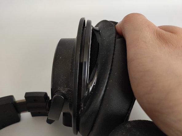

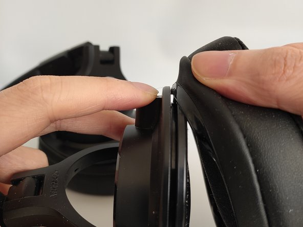

    • With one hand, hold your headphones in place while the other grips the earpad cushion.
    • Gently pry the old earpad cushion off.
    • You may need to slide it off the lip of the driver before prying it off.

    • Align the edge of new cushion to your headphone driver.
    • Slide the cushion over the headphone drivers until it is fully attached.
  6. Audio-Technica ATH-M40x Earpad Replacement: crwdns2935265:06crwdnd2935265:01crwdnd2935265:01crwdne2935265:0
    • Rotate the cushion to make sure it is securely in place.
