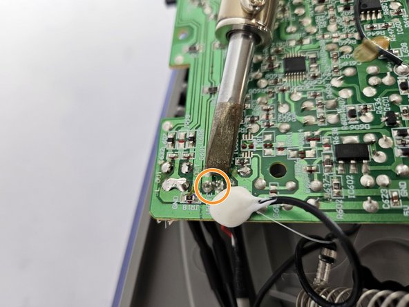

    • Use the pliers to clip off the black wire connected to the RTV Adhesive Sealant, and burn off/remove the sealant.
  7. Audio-Technica AT-LP120-USB Preamp Replacement: crwdns2935265:07crwdnd2935265:01crwdnd2935265:03crwdne2935265:0 Audio-Technica AT-LP120-USB Preamp Replacement: crwdns2935265:07crwdnd2935265:02crwdnd2935265:03crwdne2935265:0 Audio-Technica AT-LP120-USB Preamp Replacement: crwdns2935265:07crwdnd2935265:03crwdnd2935265:03crwdne2935265:0

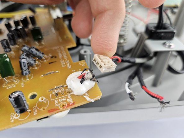

    • Heat up the soldering iron, and wait until it is at its desired heat level. It will be used in the next three steps, so ensure it doesn't overheat.
    • The soldering iron can cause severe burns if used incorrectly.
    • To solder off the white box with the red and white wire in the corner of the preamp, heat up the two metal studs on the opposite side of the preamp as shown, and gently pull the white box until it disconnects.

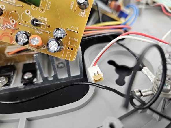

  8. Audio-Technica AT-LP120-USB Preamp Replacement: crwdns2935265:08crwdnd2935265:01crwdnd2935265:03crwdne2935265:0 Audio-Technica AT-LP120-USB Preamp Replacement: crwdns2935265:08crwdnd2935265:02crwdnd2935265:03crwdne2935265:0 Audio-Technica AT-LP120-USB Preamp Replacement: crwdns2935265:08crwdnd2935265:03crwdnd2935265:03crwdne2935265:0
    • Locate the next soldering location.
    • Use the soldering iron to heat up the two metal joints as shown in the photo, and gently pull the white box containing the wires until it disconnects.

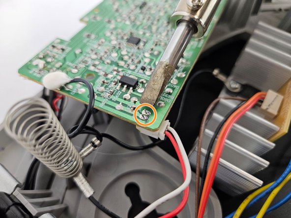

  9. Audio-Technica AT-LP120-USB Preamp Replacement: crwdns2935265:09crwdnd2935265:01crwdnd2935265:03crwdne2935265:0 Audio-Technica AT-LP120-USB Preamp Replacement: crwdns2935265:09crwdnd2935265:02crwdnd2935265:03crwdne2935265:0 Audio-Technica AT-LP120-USB Preamp Replacement: crwdns2935265:09crwdnd2935265:03crwdnd2935265:03crwdne2935265:0
    • The final location that will be soldered are 4 individual wires, and be sure to take note of their exact order to ensure a proper re-connection later.
    • To solder off/on the wires, the RVC adhesive glue will need to be removed. If that is not an option, then remove the wires with the Pliers, as shown in step 2.
    • To solder off the individual wires, hold the heated soldering iron to the metal stud connection points and gently pull each wire until they disconnect.
