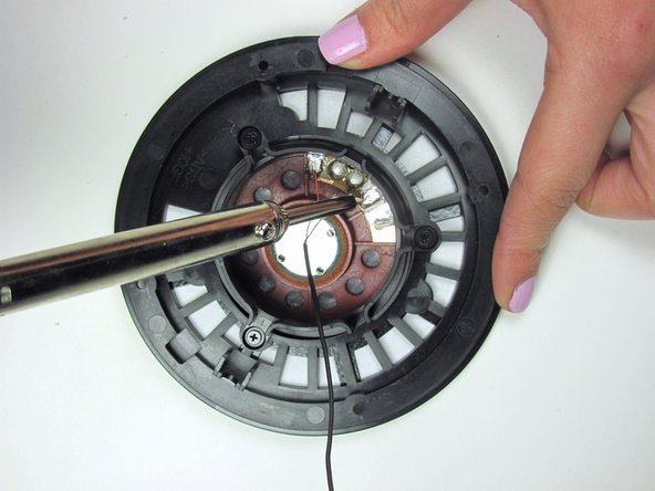

  4. Audio Technica ATH-AD500 Right Headphone Cable Replacement, Right Headphone Cable: crwdns2935265:04crwdnd2935265:01crwdnd2935265:02crwdne2935265:0 Audio Technica ATH-AD500 Right Headphone Cable Replacement, Right Headphone Cable: crwdns2935265:04crwdnd2935265:02crwdnd2935265:02crwdne2935265:0
    • Remove the wires by de-soldering both the red and yellow wires using the soldering iron and desoldering wick. If you need assistance, reference How To Solder and Desolder Connections.
    • The areas where you soldered will be hot so let the soldered joints cool for before handling again.

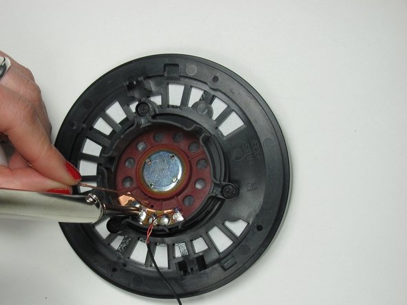

  5. Audio Technica ATH-AD500 Right Headphone Cable Replacement: crwdns2935265:05crwdnd2935265:01crwdnd2935265:02crwdne2935265:0 Audio Technica ATH-AD500 Right Headphone Cable Replacement: crwdns2935265:05crwdnd2935265:02crwdnd2935265:02crwdne2935265:0
    • Connect the the new red and yellow wires by re-soldering the wires using the soldering iron. If you need assistance, reference How To Solder and Desolder Connections.
