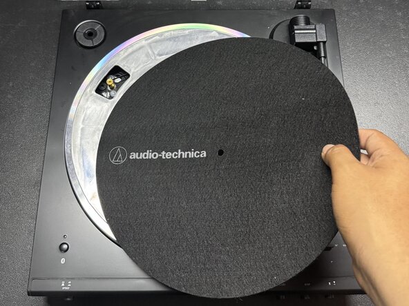

    • Remove the rubber slipmat from the turntable and place it to the side.
  3. Audio Technica AT-LP60XUSB Turntable Belt Replacement: crwdns2935265:03crwdnd2935265:01crwdnd2935265:02crwdne2935265:0 Audio Technica AT-LP60XUSB Turntable Belt Replacement: crwdns2935265:03crwdnd2935265:02crwdnd2935265:02crwdne2935265:0

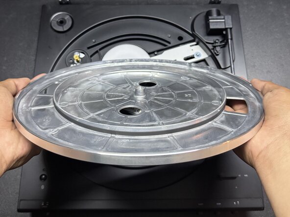

    • Pull the metallic platter with the broken belt straight up to remove it.
    • Do not use excessive force when removing the platter, as it may cause damage to internal components.

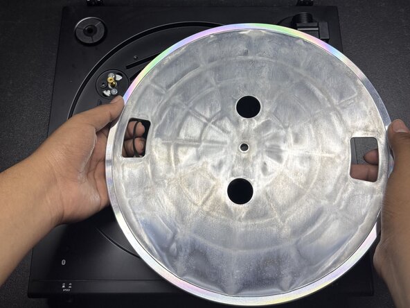

    • Flip the metallic cover upside down.
    • Remove the old belt.
    • Place the new belt around the circle on the bottom of the plate.
    • Ensure the belt lies flat and is not twisted or bunched up.

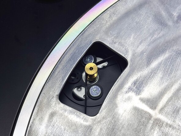

    • Flip the metallic plate over and place it onto the turntable.
    • Align the hole in the center of the plate with the silver knob in the middle of the turntable.
    • Rotate the metal plate until the rectangular opening near its edge lines up with the gold knob in the top-left corner.

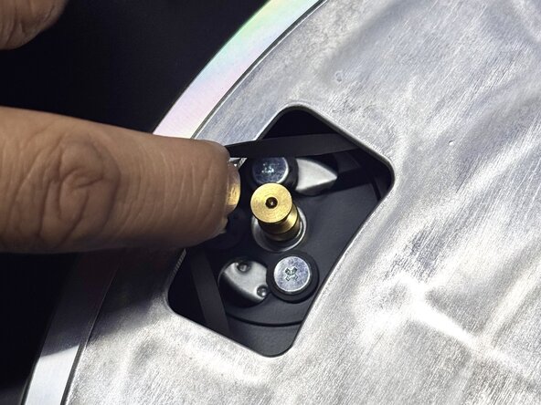

    • Use your fingers to pull the belt through the rectangular opening and loop it around the gold knob.
    • Be gentle while stretching the belt onto the pulley to avoid tearing or misalignment.

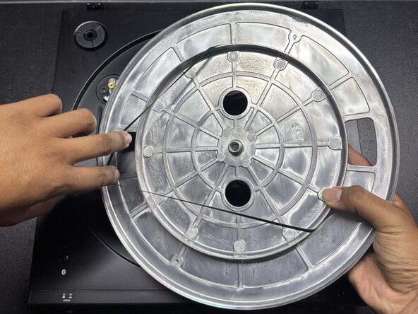

  6. Audio Technica AT-LP60XUSB Turntable Belt Replacement: crwdns2935265:06crwdnd2935265:01crwdnd2935265:01crwdne2935265:0
    • Place the rubber slipmat back on top of the turntable.
    • Connect the power to the turntable.
    • Turn the metallic plate on the turntable to confirm that the belt is spinning properly.
