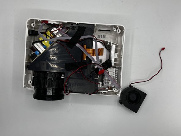

    • Carefully disconnect the wires that are attached to the motherboard.
    • Remove the motherboard.
  6. AuKing M8-F Fan Replacement, Fan: crwdns2935265:06crwdnd2935265:01crwdnd2935265:02crwdne2935265:0 AuKing M8-F Fan Replacement, Fan: crwdns2935265:06crwdnd2935265:02crwdnd2935265:02crwdne2935265:0
    • Remove the two 9 mm screws using a Phillips #0 screwdriver to detach the small black panel.
  7. AuKing M8-F Fan Replacement: crwdns2935265:07crwdnd2935265:01crwdnd2935265:02crwdne2935265:0 AuKing M8-F Fan Replacement: crwdns2935265:07crwdnd2935265:02crwdnd2935265:02crwdne2935265:0
    • Carefully pull out the fans from the projector.
