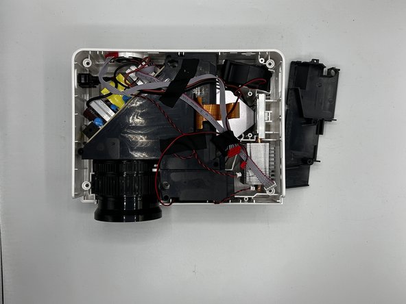

  2. AuKing M8-F Bulb Replacement: crwdns2935265:02crwdnd2935265:01crwdnd2935265:03crwdne2935265:0 AuKing M8-F Bulb Replacement: crwdns2935265:02crwdnd2935265:02crwdnd2935265:03crwdne2935265:0 AuKing M8-F Bulb Replacement: crwdns2935265:02crwdnd2935265:03crwdnd2935265:03crwdne2935265:0
    • Carefully prop open the top of the projector.
    • To remove the cord that is attached to the top, carefully wiggle the cord out.
    • Remove the top lid.
  3. AuKing M8-F Bulb Replacement: crwdns2935265:03crwdnd2935265:01crwdnd2935265:03crwdne2935265:0 AuKing M8-F Bulb Replacement: crwdns2935265:03crwdnd2935265:02crwdnd2935265:03crwdne2935265:0 AuKing M8-F Bulb Replacement: crwdns2935265:03crwdnd2935265:03crwdnd2935265:03crwdne2935265:0

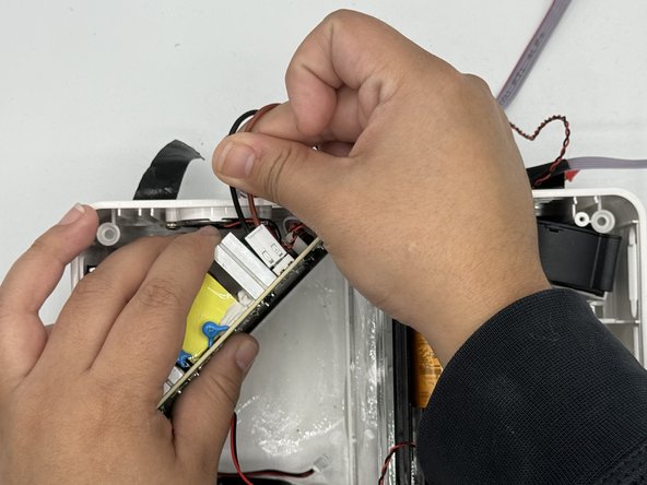

  5. AuKing M8-F Bulb Replacement: crwdns2935265:05crwdnd2935265:01crwdnd2935265:02crwdne2935265:0 AuKing M8-F Bulb Replacement: crwdns2935265:05crwdnd2935265:02crwdnd2935265:02crwdne2935265:0
    • Carefully disconnect the wires that are attached to the motherboard.
    • Remove the motherboard.

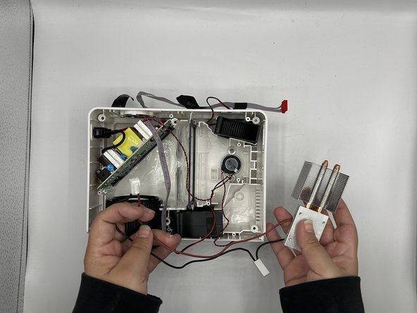

  6. AuKing M8-F Bulb Replacement, Bulb: crwdns2935265:06crwdnd2935265:01crwdnd2935265:02crwdne2935265:0 AuKing M8-F Bulb Replacement, Bulb: crwdns2935265:06crwdnd2935265:02crwdnd2935265:02crwdne2935265:0
    • Remove the six 9 mm screws using a Phillips #0 screwdriver to detach both of the black panels.
  7. AuKing M8-F Bulb Replacement: crwdns2935265:07crwdnd2935265:01crwdnd2935265:03crwdne2935265:0 AuKing M8-F Bulb Replacement: crwdns2935265:07crwdnd2935265:02crwdnd2935265:03crwdne2935265:0 AuKing M8-F Bulb Replacement: crwdns2935265:07crwdnd2935265:03crwdnd2935265:03crwdne2935265:0
    • Slide the motherboard upwards to remove the wire component connected to the LED bulb.
    • Gently remove the LED bulb and the attached heatsink from the projector
