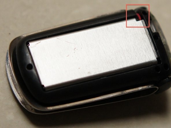

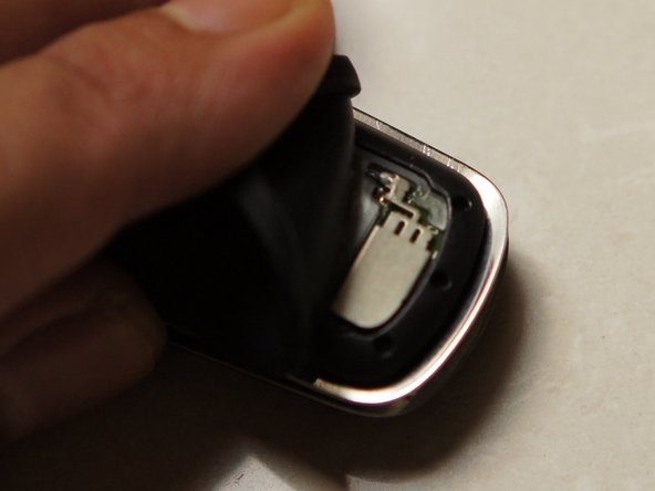

    • The Jabra Clipper's cover is actually made of very elastic rubber, which allows many hacking possibiliites!
    • You'll need to peel the cover. Start by inserting a screwdriver from any of the sides until you hit the steel chassis. Pull it upwards, and do the rest of uncovering ritual with your fingers.
    • Clean up the remaining sealant from the sides of the case. Now there the waterproofing goes! Relax, nobody needs waterproofing. Well at least, not on the level of what was offered by Jabra Clipper!
  4. Attach Your Earphones Permanently: crwdns2935265:04crwdnd2935265:01crwdnd2935265:02crwdne2935265:0 Attach Your Earphones Permanently: crwdns2935265:04crwdnd2935265:02crwdnd2935265:02crwdne2935265:0
    • Once uncovered, you'll see the main PCB on the front panel, and the battery on the back. Both top and front PCBs are covered with some transparent hard plastic protector.
    • Watch out for the battery cables, you may need to gently pull them out later. Use a screwdriver when so.
