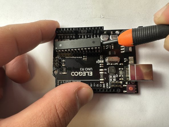

      • Place the Arduino UNO R3 board on a flat clean surface.
    2. Atmega328P Microcontroller Replacement for Arduino Board: crwdns2935265:02crwdnd2935265:01crwdnd2935265:02crwdne2935265:0 Atmega328P Microcontroller Replacement for Arduino Board: crwdns2935265:02crwdnd2935265:02crwdnd2935265:02crwdne2935265:0
      • On the right side of board, position a nylon spudger in between the microcontroller and the dip socket, and gently lift upwards to pry it out.
      • The bottom of the microcontroller can be scratched if not done carefully. Do not use a metal tool for this step.

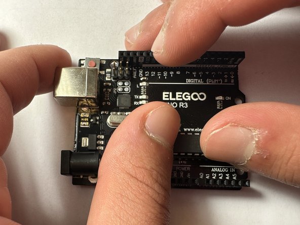

    3. Atmega328P Microcontroller Replacement for Arduino Board: crwdns2935265:03crwdnd2935265:01crwdnd2935265:02crwdne2935265:0 Atmega328P Microcontroller Replacement for Arduino Board: crwdns2935265:03crwdnd2935265:02crwdnd2935265:02crwdne2935265:0
      • Repeat the same process on the other side.
      • Lift both sides evenly to prevent any damage to the pins.

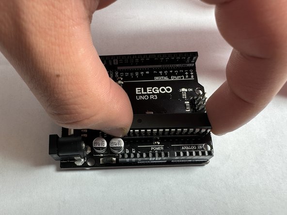

    4. Atmega328P Microcontroller Replacement for Arduino Board: crwdns2935265:04crwdnd2935265:01crwdnd2935265:03crwdne2935265:0 Atmega328P Microcontroller Replacement for Arduino Board: crwdns2935265:04crwdnd2935265:02crwdnd2935265:03crwdne2935265:0 Atmega328P Microcontroller Replacement for Arduino Board: crwdns2935265:04crwdnd2935265:03crwdnd2935265:03crwdne2935265:0
      • Repeat steps 2 and 3 until the microcontroller is loose enough to remove out of the socket.

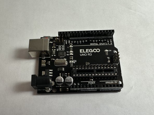

    5. Atmega328P Microcontroller Replacement for Arduino Board: crwdns2935265:05crwdnd2935265:01crwdnd2935265:01crwdne2935265:0
      • Remove replacement microcontroller out of packaging.
    6. Atmega328P Microcontroller Replacement for Arduino Board: crwdns2935265:06crwdnd2935265:01crwdnd2935265:01crwdne2935265:0
      • If needed, straighten the pins of the replacement microcontroller and place it directly over the dip socket.
      • Make sure the notch on the side of the microcontroller is facing the right, matching the white lines on the board.
    7. Atmega328P Microcontroller Replacement for Arduino Board: crwdns2935265:07crwdnd2935265:01crwdnd2935265:02crwdne2935265:0 Atmega328P Microcontroller Replacement for Arduino Board: crwdns2935265:07crwdnd2935265:02crwdnd2935265:02crwdne2935265:0
      • Gently press the microcontroller into the dip socket
