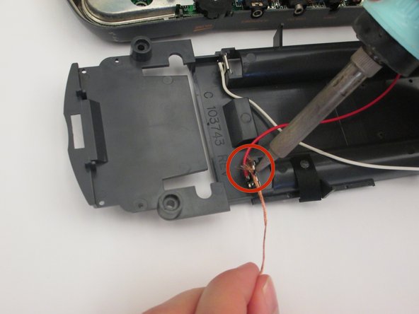

  5. Atari Lynx Battery Wire Replacement, Battery Wires: crwdns2935265:05crwdnd2935265:01crwdnd2935265:01crwdne2935265:0
    • Desolder both the black and red wire as shown.
    • If you need help with basic desoldering, click here.
  6. Atari Lynx Battery Wire Replacement: crwdns2935265:06crwdnd2935265:01crwdnd2935265:01crwdne2935265:0
    • Desolder the black wire as shown.
  7. Atari Lynx Battery Wire Replacement: crwdns2935265:07crwdnd2935265:01crwdnd2935265:02crwdne2935265:0 Atari Lynx Battery Wire Replacement: crwdns2935265:07crwdnd2935265:02crwdnd2935265:02crwdne2935265:0
    • Desolder the white wire and then the red wire as shown.
  8. Atari Lynx Battery Wire Replacement: crwdns2935265:08crwdnd2935265:01crwdnd2935265:01crwdne2935265:0
    • Desolder the white wire as shown in order for the battery pack to be completely removed from the device.
