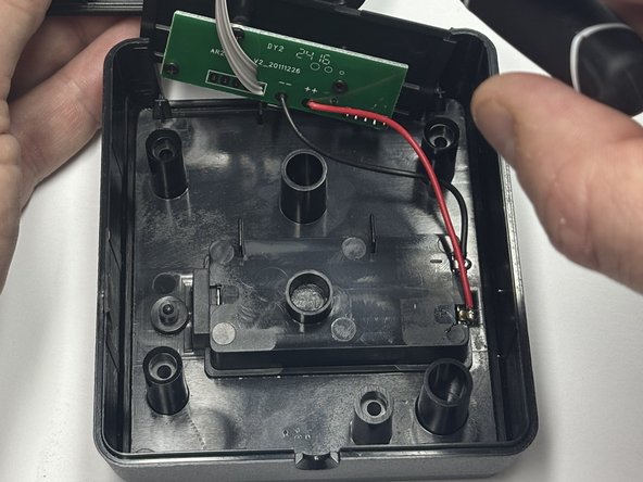

  4. Atari Flashback 6 Controller Board Repair: crwdns2935265:04crwdnd2935265:01crwdnd2935265:03crwdne2935265:0 Atari Flashback 6 Controller Board Repair: crwdns2935265:04crwdnd2935265:02crwdnd2935265:03crwdne2935265:0 Atari Flashback 6 Controller Board Repair: crwdns2935265:04crwdnd2935265:03crwdnd2935265:03crwdne2935265:0

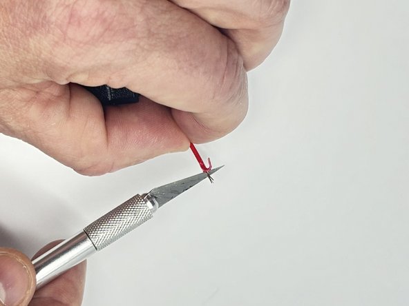

    • Separate the button board from the back panel.
    • Like a car battery, the negative terminal attaches to the black wire and the positive with the red wire.
    • You may have to strip the wires to expose the internal copper wiring.
    • Use a wire stripper to expose the internal wiring to secure a proper connection in the next step.

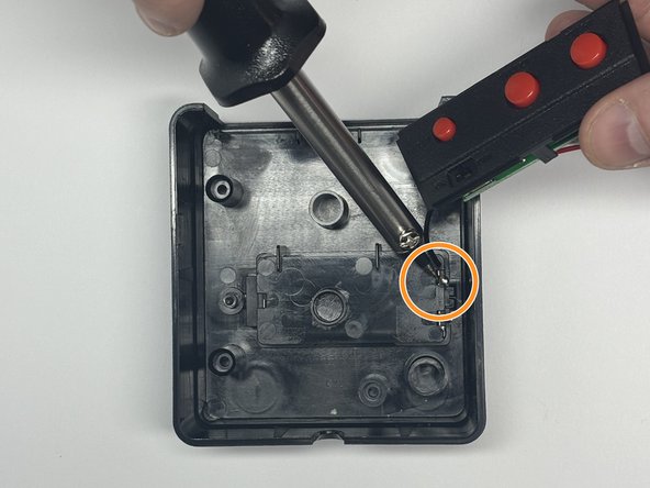

  5. Atari Flashback 6 Controller Board Repair: crwdns2935265:05crwdnd2935265:01crwdnd2935265:02crwdne2935265:0 Atari Flashback 6 Controller Board Repair: crwdns2935265:05crwdnd2935265:02crwdnd2935265:02crwdne2935265:0
    • Using a soldering iron can be dangerous. Because of the high temperature, please be sure to exercise caution when using this tool.
    • Attach the red wire to the positive terminal using the soldering iron, melting the solder to create a connection.
    • Attach the black wire to the negative terminal using the soldering iron, melting the solder to create a connection.
  6. Atari Flashback 6 Controller Board Repair: crwdns2935265:06crwdnd2935265:01crwdnd2935265:02crwdne2935265:0 Atari Flashback 6 Controller Board Repair: crwdns2935265:06crwdnd2935265:02crwdnd2935265:02crwdne2935265:0
    • Use a Phillips #1 screwdriver to replace the 2 mm screw that secures the motherboard to the top case.
    • Make sure to not pull on wires that are now attached.
