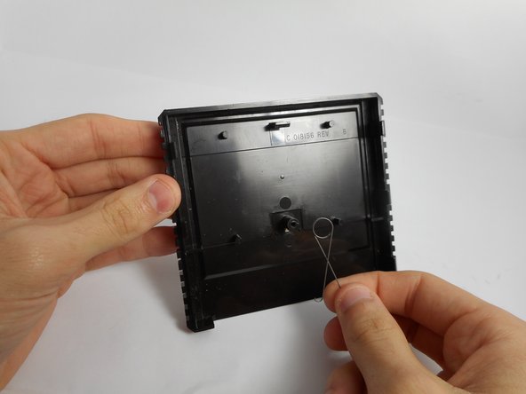

      • Place the two contact protectors together.
      • Place the spring on the knob in the cartridge.
    4. Atari 5200 Game Cartridge Disassembly, Reassembly, Part 2: crwdns2935265:04crwdnd2935265:01crwdnd2935265:03crwdne2935265:0 Atari 5200 Game Cartridge Disassembly, Reassembly, Part 2: crwdns2935265:04crwdnd2935265:02crwdnd2935265:03crwdne2935265:0 Atari 5200 Game Cartridge Disassembly, Reassembly, Part 2: crwdns2935265:04crwdnd2935265:03crwdnd2935265:03crwdne2935265:0

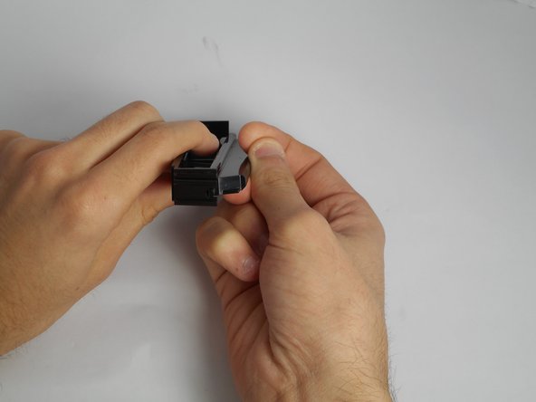

      • Thread the spring into the connected plates.
      • Push the plates into the cartridge against the pressure of the spring.
