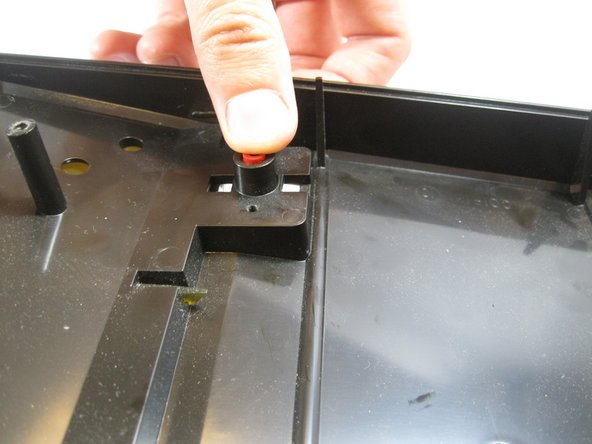

      • Gently flip the Atari Entertainment System over. You'll see 7 screws holding the system together. Use a philips head screw driver to remove all seven screws.
      • Pictured above is the Atari 5200 upside down. The orange edited circles over all 7 screws.
    2. Atari 5200 Entertainment System Power Button Replacement: crwdns2935265:02crwdnd2935265:01crwdnd2935265:01crwdne2935265:0

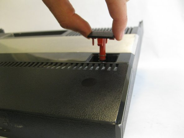

      • Gently flip the Atari Entertainment System over to the front side. Remove the top.

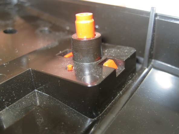

      • There are orange objects on the side of the system's top, pinch them.
      • If the triangles cannot be gripped, push the power button on the opposite side. This will lift the triangle to give access to easier grip.

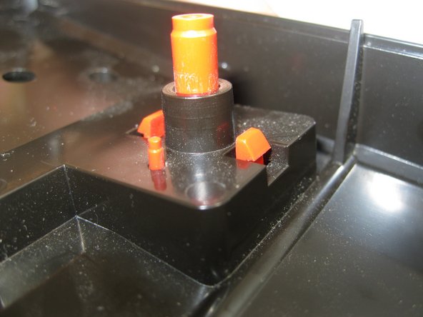

      • The Power button can now be removed/clean/replaced.
      • Be sure to keep an eye on the spring.
