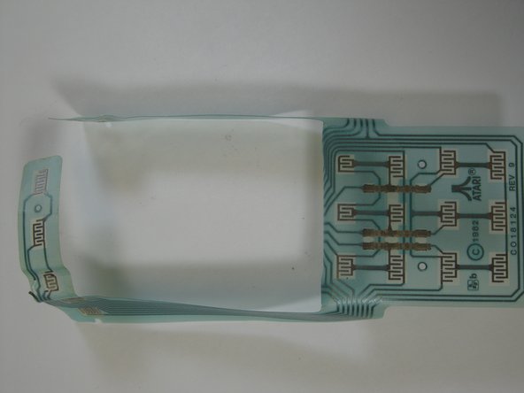

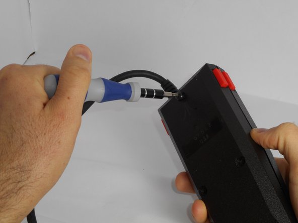

One of the most common issues with the Atari 5200 is faulty controller wiring- a controller's buttons will become unresponsive, hard to press, or even stuck in place. This guide will cover replacing the entire circuit board for the buttons, reseating each button to ensure proper contact and operation of each button.
crwdns2944105:0crwdne2944105:0
  1. Atari 5200 Controller Flex Board Replacement, Opening up the controller: crwdns2935265:01crwdnd2935265:01crwdnd2935265:03crwdne2935265:0 Atari 5200 Controller Flex Board Replacement, Opening up the controller: crwdns2935265:01crwdnd2935265:02crwdnd2935265:03crwdne2935265:0 Atari 5200 Controller Flex Board Replacement, Opening up the controller: crwdns2935265:01crwdnd2935265:03crwdnd2935265:03crwdne2935265:0
    • Turn the controller over, exposing the three screws on the back. Use a 6mm screwdriver to remove these screws.
    • Carefully slide and pull the two parts of the controller shell apart, exposing the innards.
    • Try not to move the joystick when reassembling. This will almost assuredly break your alignment. The less the joystick is moved, the easier it will be to realign the joystick to the pots.

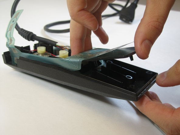

  2. Atari 5200 Controller Flex Board Replacement, Removing the Circuit Board: crwdns2935265:02crwdnd2935265:01crwdnd2935265:03crwdne2935265:0 Atari 5200 Controller Flex Board Replacement, Removing the Circuit Board: crwdns2935265:02crwdnd2935265:02crwdnd2935265:03crwdne2935265:0 Atari 5200 Controller Flex Board Replacement, Removing the Circuit Board: crwdns2935265:02crwdnd2935265:03crwdnd2935265:03crwdne2935265:0
    • Slide out the strip of the board connected to the controller's START, PAUSE, and RESET buttons.

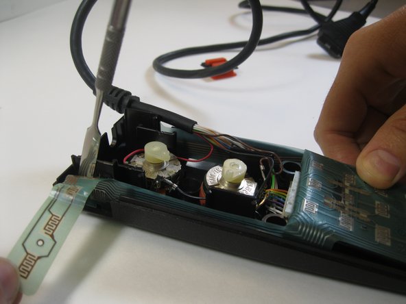

  3. Atari 5200 Controller Flex Board Replacement: crwdns2935265:03crwdnd2935265:01crwdnd2935265:03crwdne2935265:0 Atari 5200 Controller Flex Board Replacement: crwdns2935265:03crwdnd2935265:02crwdnd2935265:03crwdne2935265:0 Atari 5200 Controller Flex Board Replacement: crwdns2935265:03crwdnd2935265:03crwdnd2935265:03crwdne2935265:0
    • Peel off the old circuit board.
    • The buttons should fall out/be removable.
    • Disconnect it from the wire connector.

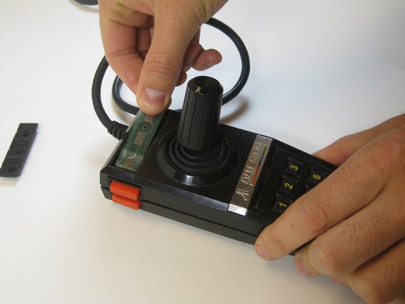

  4. Atari 5200 Controller Flex Board Replacement, Adding the new board: crwdns2935265:04crwdnd2935265:01crwdnd2935265:03crwdne2935265:0 Atari 5200 Controller Flex Board Replacement, Adding the new board: crwdns2935265:04crwdnd2935265:02crwdnd2935265:03crwdne2935265:0 Atari 5200 Controller Flex Board Replacement, Adding the new board: crwdns2935265:04crwdnd2935265:03crwdnd2935265:03crwdne2935265:0
    • Place the new circuit board where the old one was.
    • Glue/tape it in places where the previous board was held.
    • Connect it to the wire connector.

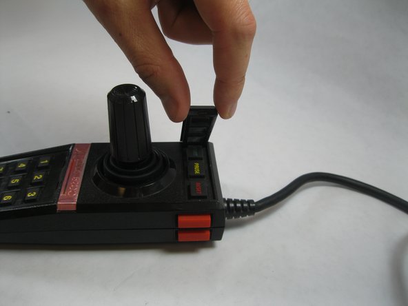

  5. Atari 5200 Controller Flex Board Replacement, Reassembly Part 1: crwdns2935265:05crwdnd2935265:01crwdnd2935265:02crwdne2935265:0 Atari 5200 Controller Flex Board Replacement, Reassembly Part 1: crwdns2935265:05crwdnd2935265:02crwdnd2935265:02crwdne2935265:0
    • Use a spudger to remove the top frame.
    • Take off the plate.
    • Remove the rubber buttons.

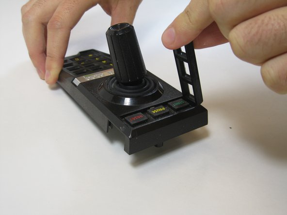

  7. Atari 5200 Controller Flex Board Replacement: crwdns2935265:07crwdnd2935265:01crwdnd2935265:03crwdne2935265:0 Atari 5200 Controller Flex Board Replacement: crwdns2935265:07crwdnd2935265:02crwdnd2935265:03crwdne2935265:0 Atari 5200 Controller Flex Board Replacement: crwdns2935265:07crwdnd2935265:03crwdnd2935265:03crwdne2935265:0
    • Return the buttons to the top of the controller.
    • Snap the frame back into place.
    • Screw the Screws
