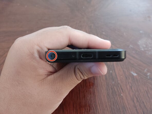

  1. Asus Zenfone 10 SIM Card Replacement, Locate the SIM tray: crwdns2935265:01crwdnd2935265:01crwdnd2935265:01crwdne2935265:0
    • If a case is installed, remove it.
    • Locate the SIM eject hole on the left side of the SIM tray.

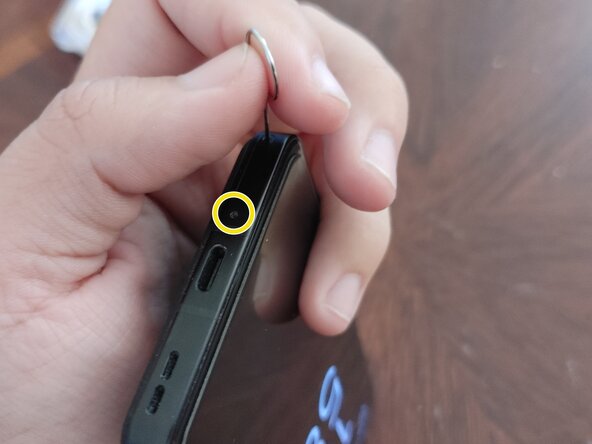

  2. Asus Zenfone 10 SIM Card Replacement, Insert SIM tool: crwdns2935265:02crwdnd2935265:01crwdnd2935265:01crwdne2935265:0
    • Insert a SIM eject tool (or an unfolded paper clip, if you don't have a tool) into the SIM eject hole.
    • Do not insert the tool into the microphone next to the SIM tray (circled).
