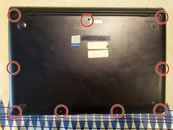

  1. Asus Zenbook UX391UA Thermal Paste Replacement, Open back-cover: crwdns2935265:01crwdnd2935265:01crwdnd2935265:01crwdne2935265:0
    • Remove the laptops back cover by unscrewing the 9 T5 screws

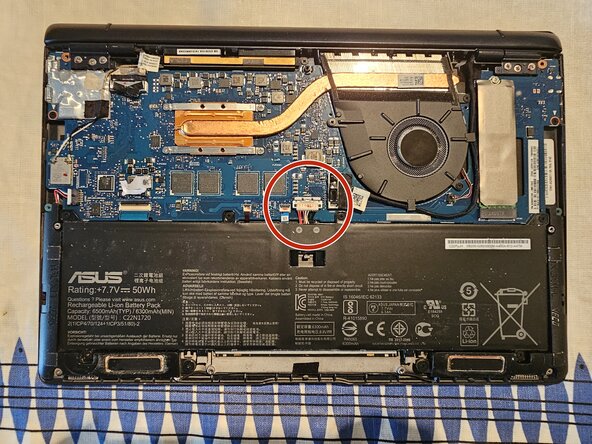

  2. Asus Zenbook UX391UA Thermal Paste Replacement, Unplug the battery connector: crwdns2935265:02crwdnd2935265:01crwdnd2935265:02crwdne2935265:0 Asus Zenbook UX391UA Thermal Paste Replacement, Unplug the battery connector: crwdns2935265:02crwdnd2935265:02crwdnd2935265:02crwdne2935265:0
    • Before proceeding the battery needs to be disconnected.
    • Lift the metal clip on the connector and then lift the plastic connector itself. Use a pointy plastic tool to help.
