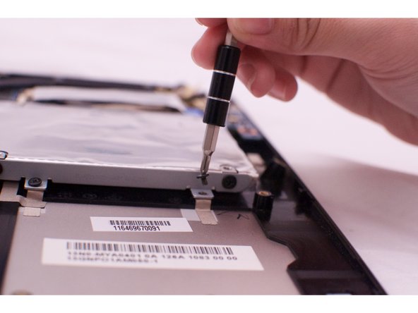

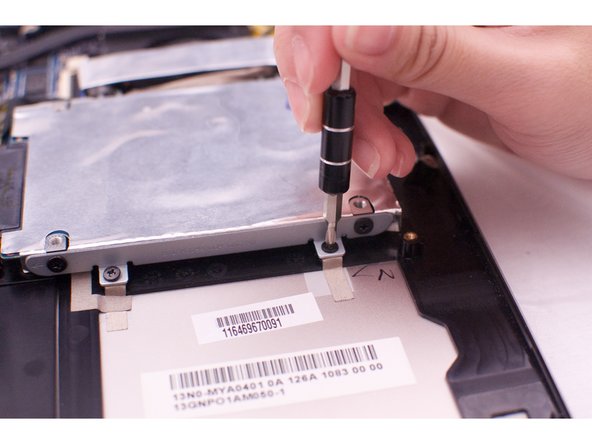

  8. Asus Zenbook UX32VD Hard Drive Replacement: crwdns2935265:08crwdnd2935265:01crwdnd2935265:03crwdne2935265:0 Asus Zenbook UX32VD Hard Drive Replacement: crwdns2935265:08crwdnd2935265:02crwdnd2935265:03crwdne2935265:0 Asus Zenbook UX32VD Hard Drive Replacement: crwdns2935265:08crwdnd2935265:03crwdnd2935265:03crwdne2935265:0
    • Lift the hard drive slightly and gently pull the hard drive from the socket.
    • Do not lift the hard drive too high. Doing so could damage the hard drive or other internal components of the laptop.
    • Remove the hard drive completely.
