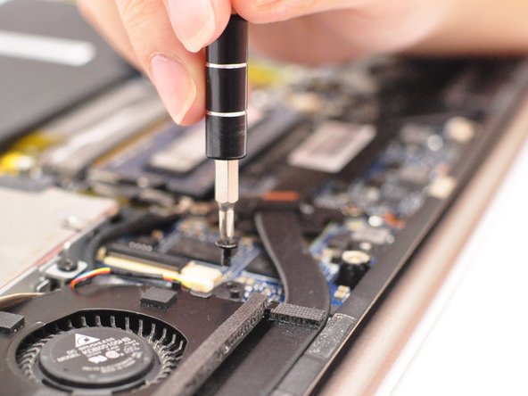

    $9.99
  2. Asus Zenbook UX32VD GPU Fan Replacement: crwdns2935265:02crwdnd2935265:01crwdnd2935265:03crwdne2935265:0 Asus Zenbook UX32VD GPU Fan Replacement: crwdns2935265:02crwdnd2935265:02crwdnd2935265:03crwdne2935265:0 Asus Zenbook UX32VD GPU Fan Replacement: crwdns2935265:02crwdnd2935265:03crwdnd2935265:03crwdne2935265:0
    • Use a plastic opening tool to pry along the perimeter of the bottom panel until it can be easily removed.
    • Remove the bottom panel from the body of the laptop.
    • Set aside the bottom panel.

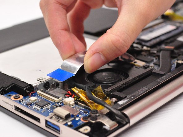

  3. Asus Zenbook UX32VD GPU Fan Replacement, Fan: crwdns2935265:03crwdnd2935265:01crwdnd2935265:03crwdne2935265:0 Asus Zenbook UX32VD GPU Fan Replacement, Fan: crwdns2935265:03crwdnd2935265:02crwdnd2935265:03crwdne2935265:0 Asus Zenbook UX32VD GPU Fan Replacement, Fan: crwdns2935265:03crwdnd2935265:03crwdnd2935265:03crwdne2935265:0
    Spudger
    $2.99
    • Use the tip of your spudger or your fingernail to open the ZIF connector on the I/O board.
    • Be sure to pry up on the hinged retaining flap, not the connector itself.
    • Remove the metallic ribbon cable from the connector .
    • No force is needed to remove or insert the cable.

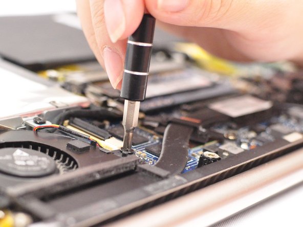

  4. Asus Zenbook UX32VD GPU Fan Replacement: crwdns2935265:04crwdnd2935265:01crwdnd2935265:03crwdne2935265:0 Asus Zenbook UX32VD GPU Fan Replacement: crwdns2935265:04crwdnd2935265:02crwdnd2935265:03crwdne2935265:0 Asus Zenbook UX32VD GPU Fan Replacement: crwdns2935265:04crwdnd2935265:03crwdnd2935265:03crwdne2935265:0
    Phillips #0 Screwdriver
    $5.49

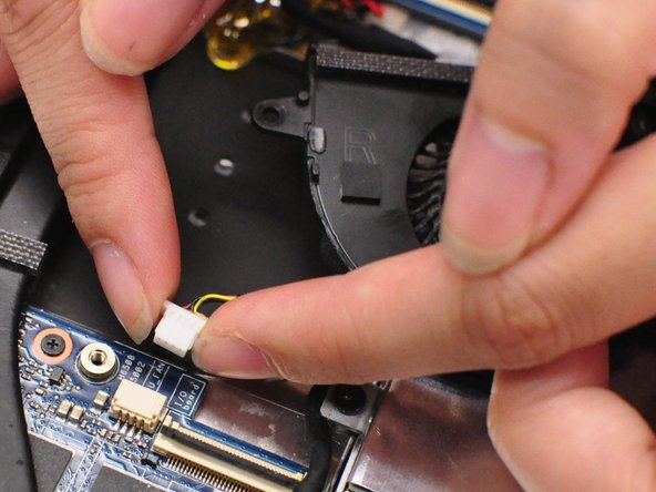

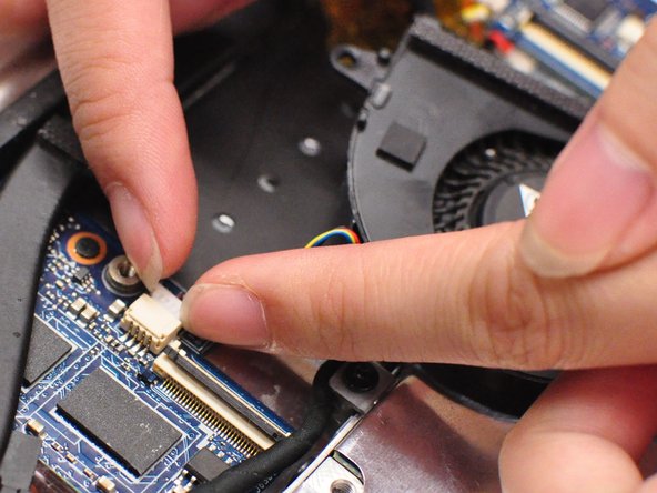

  5. Asus Zenbook UX32VD GPU Fan Replacement: crwdns2935265:05crwdnd2935265:01crwdnd2935265:03crwdne2935265:0 Asus Zenbook UX32VD GPU Fan Replacement: crwdns2935265:05crwdnd2935265:02crwdnd2935265:03crwdne2935265:0 Asus Zenbook UX32VD GPU Fan Replacement: crwdns2935265:05crwdnd2935265:03crwdnd2935265:03crwdne2935265:0
    • Unplug the bundled cable connector.
    • Move the fan as shown in the first picture to better access the connector.
    • Pull the cable away from the connector in the same direction as the individual wires are running.
    • Pull evenly on the full width of the cable so that no individual wires are overly strained.

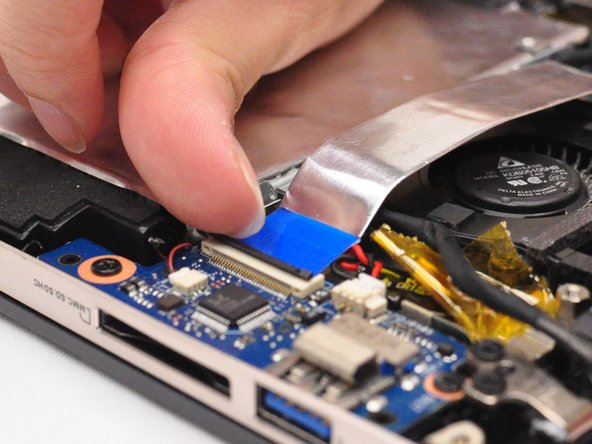

  6. Asus Zenbook UX32VD GPU Fan Replacement: crwdns2935265:06crwdnd2935265:01crwdnd2935265:01crwdne2935265:0
    • Remove the fan completely.
