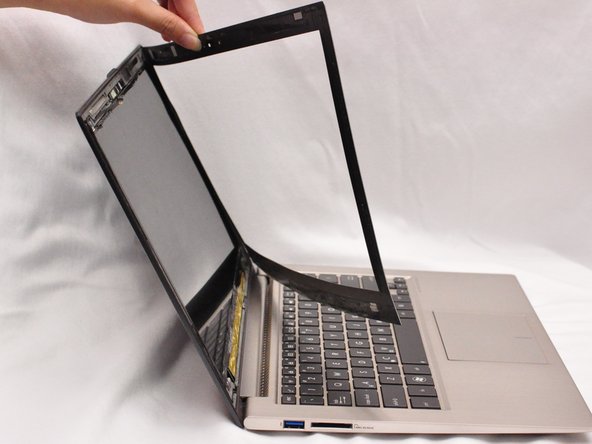

    • Heat the adhesive behind the screen frame with a hair dryer or a heat gun.
    • Use low heat with the heat gun. Over heating could damage delicate electronic components.
  2. Asus Zenbook UX32VD  HD Web Camera Replacement: crwdns2935265:02crwdnd2935265:01crwdnd2935265:03crwdne2935265:0 Asus Zenbook UX32VD  HD Web Camera Replacement: crwdns2935265:02crwdnd2935265:02crwdnd2935265:03crwdne2935265:0 Asus Zenbook UX32VD  HD Web Camera Replacement: crwdns2935265:02crwdnd2935265:03crwdnd2935265:03crwdne2935265:0
    • Insert a spudger between the display screen frame and the back screen panel.
    • Pry the display screen frame away from the back screen panel.
    • Continue to heat and remove the display screen frame along the whole perimeter.

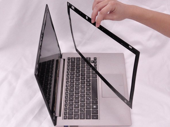

  3. Asus Zenbook UX32VD  HD Web Camera Replacement: crwdns2935265:03crwdnd2935265:01crwdnd2935265:03crwdne2935265:0 Asus Zenbook UX32VD  HD Web Camera Replacement: crwdns2935265:03crwdnd2935265:02crwdnd2935265:03crwdne2935265:0 Asus Zenbook UX32VD  HD Web Camera Replacement: crwdns2935265:03crwdnd2935265:03crwdnd2935265:03crwdne2935265:0
    • Remove display screen frame completely before adhesive cools and hardens.

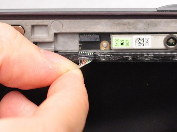

  4. Asus Zenbook UX32VD  HD Web Camera Replacement: crwdns2935265:04crwdnd2935265:01crwdnd2935265:02crwdne2935265:0 Asus Zenbook UX32VD  HD Web Camera Replacement: crwdns2935265:04crwdnd2935265:02crwdnd2935265:02crwdne2935265:0
    • Unplug the bundled cable connector.
    • Pull the cable away from the connector in the same direction as the individual wires are running.
    • Pull evenly on the full width of the cable so that no individual wires are overly strained.

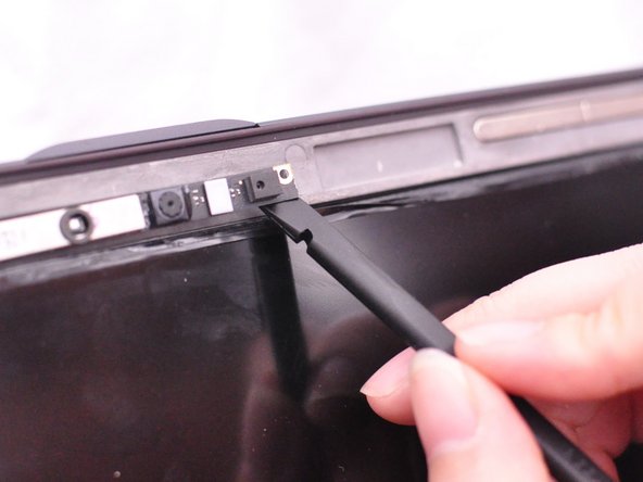

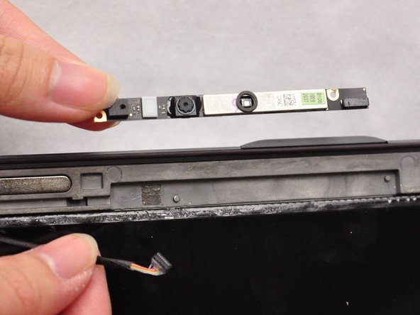

  5. Asus Zenbook UX32VD  HD Web Camera Replacement: crwdns2935265:05crwdnd2935265:01crwdnd2935265:03crwdne2935265:0 Asus Zenbook UX32VD  HD Web Camera Replacement: crwdns2935265:05crwdnd2935265:02crwdnd2935265:03crwdne2935265:0 Asus Zenbook UX32VD  HD Web Camera Replacement: crwdns2935265:05crwdnd2935265:03crwdnd2935265:03crwdne2935265:0
    • Pry the camera out from the two pins on the left and right of the camera with the tip of a spudger.
    • Remove the camera completely.
