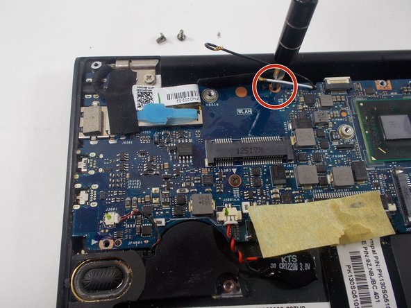

  6. Asus Zenbook UX31A Motherboard Replacement: crwdns2935265:06crwdnd2935265:01crwdnd2935265:02crwdne2935265:0 Asus Zenbook UX31A Motherboard Replacement: crwdns2935265:06crwdnd2935265:02crwdnd2935265:02crwdne2935265:0
    • Use a Phillips #00 screwdriver to remove the two 6 mm screws that secure the Wi-Fi card.
    • Wires are loose and easy to disconnect.
  7. Asus Zenbook UX31A Motherboard Replacement: crwdns2935265:07crwdnd2935265:01crwdnd2935265:01crwdne2935265:0
    • Gently pull the the Wi-Fi card from the motherboard.
    • Disconnect the white and black wire by gently pulling each one up.
    • They can be a little tricky to put back on so take your time and be gentle.

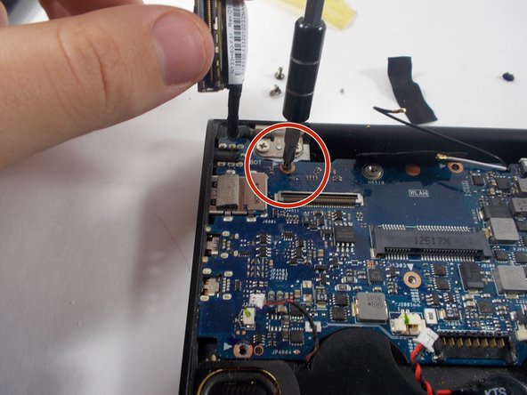

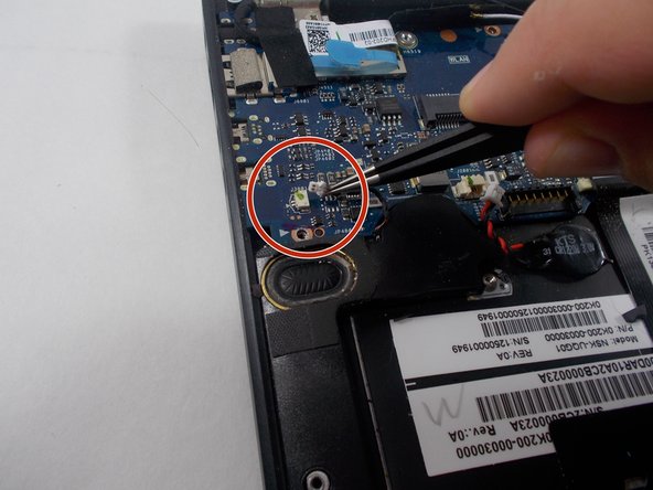

    • Disconnect the bundled connectors by pulling the cable away from the connector in the same direction that the individual wires are running.
    • Disconnect the ZIF connector by using the tip of the spudger tool or your fingernail to lift the locking tab. Then, gently pull the cable out.
  12. Asus Zenbook UX31A Motherboard Replacement: crwdns2935265:012crwdnd2935265:01crwdnd2935265:01crwdne2935265:0
    • To disconnect the display connector, use the iFixit opening tool and pry the connector up and away from the board.
  13. Asus Zenbook UX31A Motherboard Replacement: crwdns2935265:013crwdnd2935265:01crwdnd2935265:03crwdne2935265:0 Asus Zenbook UX31A Motherboard Replacement: crwdns2935265:013crwdnd2935265:02crwdnd2935265:03crwdne2935265:0 Asus Zenbook UX31A Motherboard Replacement: crwdns2935265:013crwdnd2935265:03crwdnd2935265:03crwdne2935265:0
    • Use a Phillips #00 screwdriver to remove the four 6 mm screws that hold the motherboard in place.
    • Use a Phillips #000 screwdriver to remove the single 4 mm screw.
