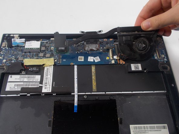

  5. Asus Zenbook UX31A Daughterboard Replacement, Fan: crwdns2935265:05crwdnd2935265:01crwdnd2935265:02crwdne2935265:0 Asus Zenbook UX31A Daughterboard Replacement, Fan: crwdns2935265:05crwdnd2935265:02crwdnd2935265:02crwdne2935265:0
    • Unclip both ZIF connector tabs by lifting the black tab up and away from the connector.
    • Remove the bridge connector.

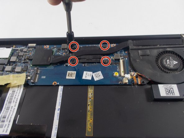

  6. Asus Zenbook UX31A Daughterboard Replacement: crwdns2935265:06crwdnd2935265:01crwdnd2935265:03crwdne2935265:0 Asus Zenbook UX31A Daughterboard Replacement: crwdns2935265:06crwdnd2935265:02crwdnd2935265:03crwdne2935265:0 Asus Zenbook UX31A Daughterboard Replacement: crwdns2935265:06crwdnd2935265:03crwdnd2935265:03crwdne2935265:0
    • Use a Phillips #00 screwdriver to remove all seven 6 mm screws that secure the fan and heatsink.

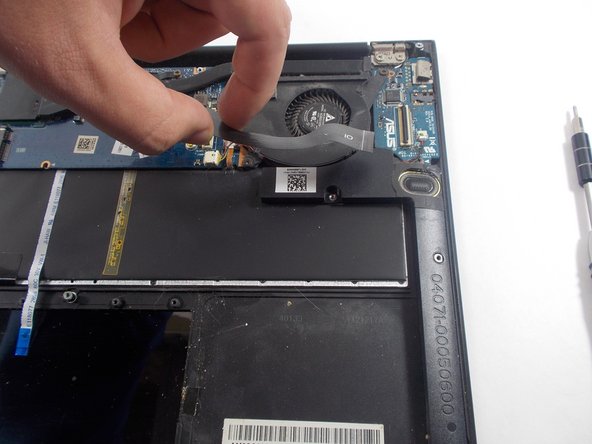

  7. Asus Zenbook UX31A Daughterboard Replacement: crwdns2935265:07crwdnd2935265:01crwdnd2935265:02crwdne2935265:0 Asus Zenbook UX31A Daughterboard Replacement: crwdns2935265:07crwdnd2935265:02crwdnd2935265:02crwdne2935265:0
    • Disconnect the fan connector by pulling on it horizontally until it disconnects.
    • Remove the fan.

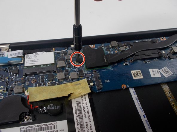

  8. Asus Zenbook UX31A Daughterboard Replacement, Daughterboard: crwdns2935265:08crwdnd2935265:01crwdnd2935265:01crwdne2935265:0
    • Use tweezers to detach the cable from the board by pulling them gently toward the bottom edge of the board.
  9. Asus Zenbook UX31A Daughterboard Replacement: crwdns2935265:09crwdnd2935265:01crwdnd2935265:01crwdne2935265:0
    • Use a Phillips #00 screwdriver to remove the 6 mm screw that secures the daughterboard.
