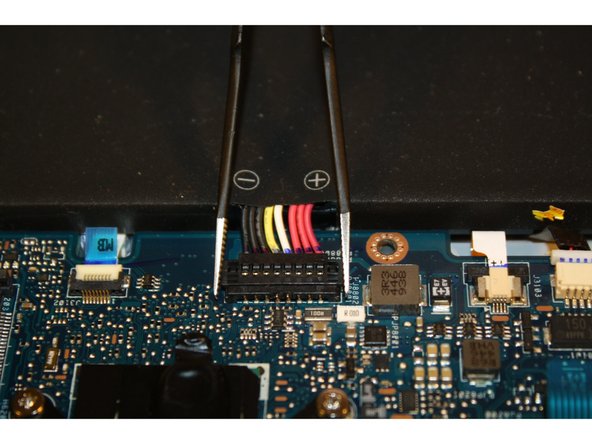

  4. Asus Zenbook UX303L Trackpad Replacement: crwdns2935265:04crwdnd2935265:01crwdnd2935265:03crwdne2935265:0 Asus Zenbook UX303L Trackpad Replacement: crwdns2935265:04crwdnd2935265:02crwdnd2935265:03crwdne2935265:0 Asus Zenbook UX303L Trackpad Replacement: crwdns2935265:04crwdnd2935265:03crwdnd2935265:03crwdne2935265:0
    • Unhook the red, black, and white coiled switch.
    • Detach the positive and negative red, black, yellow, and white switch from the motherboard.

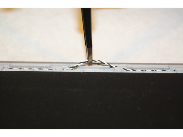

    • Unhook the black and white coiled wire from the top of the battery pack.

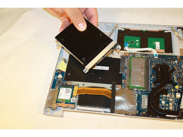

  5. Asus Zenbook UX303L Trackpad Replacement: crwdns2935265:05crwdnd2935265:01crwdnd2935265:03crwdne2935265:0 Asus Zenbook UX303L Trackpad Replacement: crwdns2935265:05crwdnd2935265:02crwdnd2935265:03crwdne2935265:0 Asus Zenbook UX303L Trackpad Replacement: crwdns2935265:05crwdnd2935265:03crwdnd2935265:03crwdne2935265:0
    • Remove the three screws connecting the SSD to the motherboard.
    • Gently lift and pull out the SSD.

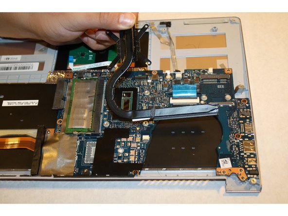

  6. Asus Zenbook UX303L Trackpad Replacement: crwdns2935265:06crwdnd2935265:01crwdnd2935265:03crwdne2935265:0 Asus Zenbook UX303L Trackpad Replacement: crwdns2935265:06crwdnd2935265:02crwdnd2935265:03crwdne2935265:0 Asus Zenbook UX303L Trackpad Replacement: crwdns2935265:06crwdnd2935265:03crwdnd2935265:03crwdne2935265:0

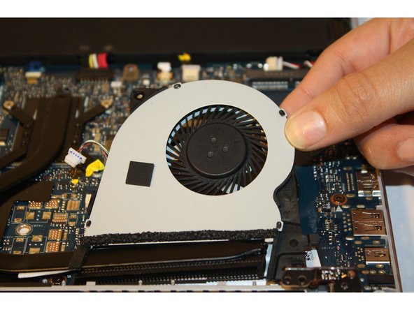

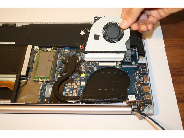

    • Remove the screw attaching the cooling fan to the motherboard.
    • Lift and remove the cooling fan.

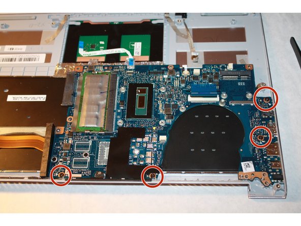

  8. Asus Zenbook UX303L Trackpad Replacement: crwdns2935265:08crwdnd2935265:01crwdnd2935265:03crwdne2935265:0 Asus Zenbook UX303L Trackpad Replacement: crwdns2935265:08crwdnd2935265:02crwdnd2935265:03crwdne2935265:0 Asus Zenbook UX303L Trackpad Replacement: crwdns2935265:08crwdnd2935265:03crwdnd2935265:03crwdne2935265:0
    • Remove the silver tape to reveal the fourth screw on the motherboard.
    • Detach the motherboard by removing the four Phillips #1 screws.
    • Detach the white wire connecting the motherboard by lifting the black flap and pulling it out.

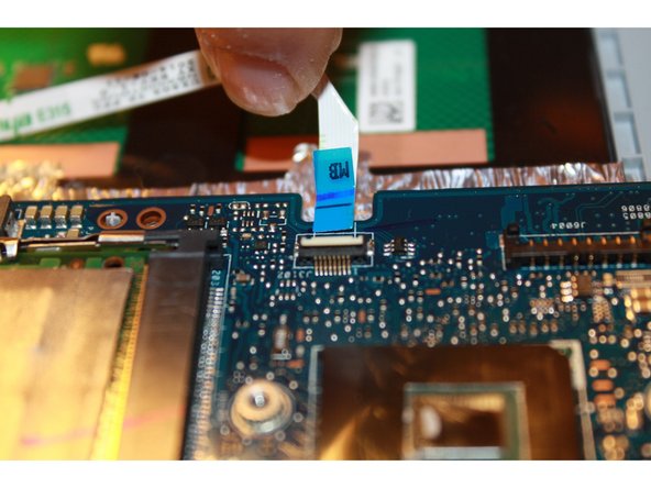

    • Remove the blue colored wire by lifting the black flap and pulling the blue flap out.

    • Remove the white wire with the blue ends by lifting the black flap with tweezers and gently pulling out.

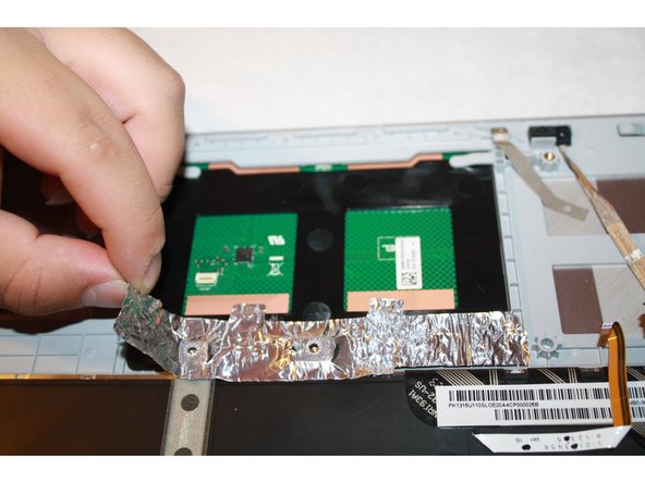

    • Gently remove the silver tape using tweezers.
    • Remove the Phillips #1 screws.

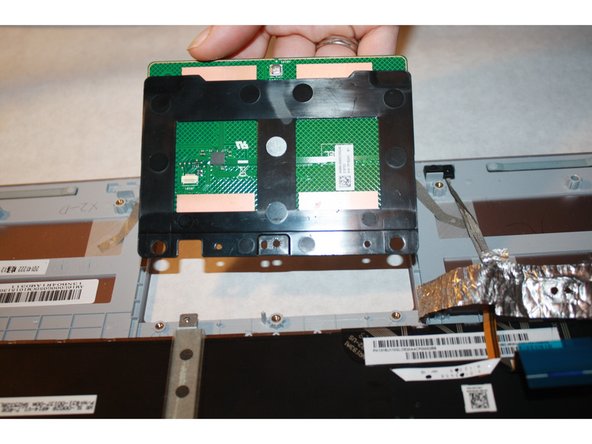

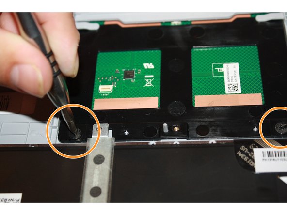

  11. Asus Zenbook UX303L Trackpad Replacement: crwdns2935265:011crwdnd2935265:01crwdnd2935265:02crwdne2935265:0 Asus Zenbook UX303L Trackpad Replacement: crwdns2935265:011crwdnd2935265:02crwdnd2935265:02crwdne2935265:0
    • Place the plastic opening tools under the trackpad.
    • Gently pull out and remove the trackpad.
