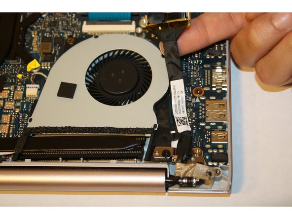

    • Pull on the black flap to lift the LVDS cable next to the cooling fan.

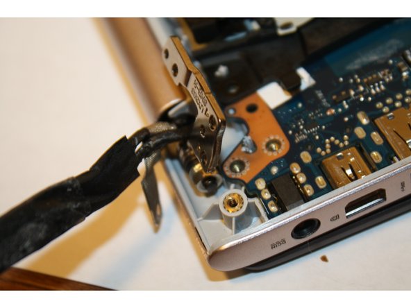

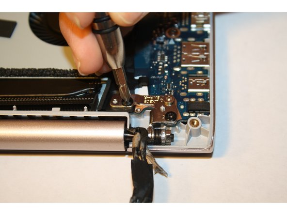

    • Remove the three screws from the hinges using a PH-1 screwdriver.
    • Open the device at a 90 degree angle to free the hinges.

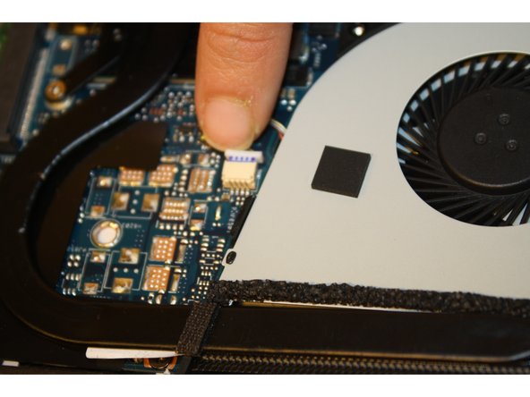

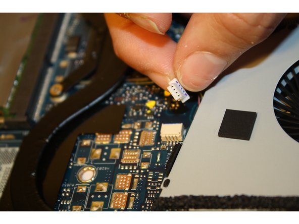

    • Remove the screws attached to the cooling fan with a PH-1 screwdriver.
    • Disconnect the wire attaching the cooling fan to the motherboard.

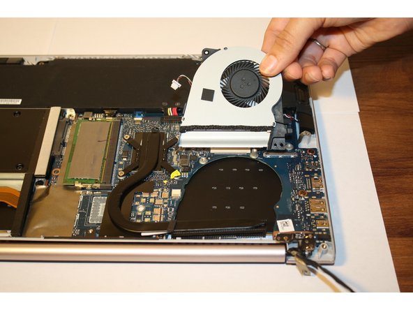

    • Gently lift and slide the cooling fan out.
