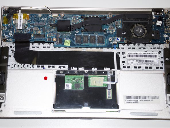

    • Using a T4 Torx screwdriver, unscrew the ten screws lining the bottom cover. Then, proceed to remove the bottom cover by sliding it out parallel toward the back of the computer.
    • There are two length of screws. Eight screws are 3mm and two are 5mm. The two 5mm screws always go into the two center holes along the back edge.

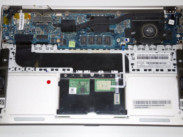

    • Using an iFixit opening tool and your other hand, gently lift the connector up from the tape wrapped around the connector wires and pry the connector from the motherboard.

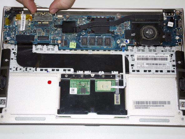

    • Remove the battery by unscrewing the five 3mm screws using a Phillips #1 screwdriver.
    • One at each corner and one in the center.

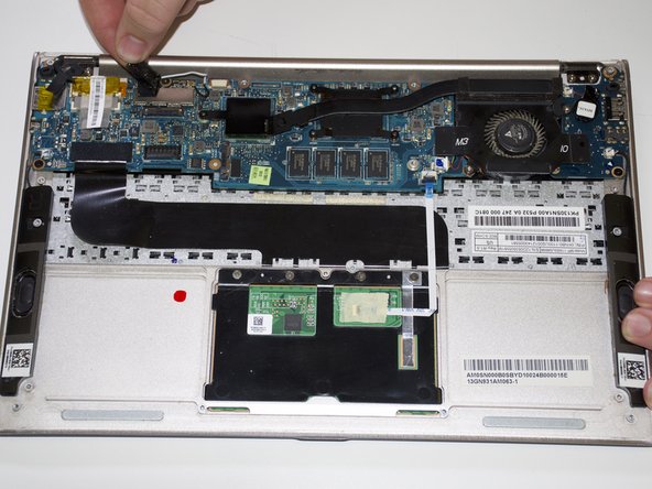

    • Lift the battery directly up and remove it from the device.
