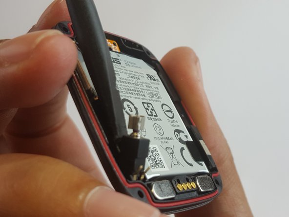

    • Remove the watch strap by sliding the knob inward to detach from the face plate.
  2. Asus ZenWatch 2 Vibration Motor Replacement: crwdns2935265:02crwdnd2935265:01crwdnd2935265:02crwdne2935265:0 Asus ZenWatch 2 Vibration Motor Replacement: crwdns2935265:02crwdnd2935265:02crwdnd2935265:02crwdne2935265:0
    • Open the watch by removing the four 3.5mm screws using the T5 screwdriver.
  3. Asus ZenWatch 2 Vibration Motor Replacement: crwdns2935265:03crwdnd2935265:01crwdnd2935265:02crwdne2935265:0 Asus ZenWatch 2 Vibration Motor Replacement: crwdns2935265:03crwdnd2935265:02crwdnd2935265:02crwdne2935265:0
    • Place the spudger under the vibration motor and lift up to remove it from the watch.
