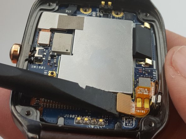

      • Remove the four 3.5mm screws using a T5 screwdriver to open the faceplate.
    2. Asus ZenWatch 2 Motherboard Replacement: crwdns2935265:02crwdnd2935265:01crwdnd2935265:02crwdne2935265:0 Asus ZenWatch 2 Motherboard Replacement: crwdns2935265:02crwdnd2935265:02crwdnd2935265:02crwdne2935265:0
      • Remove the two 1.8mm silver screws using the PH00 screwdriver.
    3. Asus ZenWatch 2 Motherboard Replacement: crwdns2935265:03crwdnd2935265:01crwdnd2935265:02crwdne2935265:0 Asus ZenWatch 2 Motherboard Replacement: crwdns2935265:03crwdnd2935265:02crwdnd2935265:02crwdne2935265:0

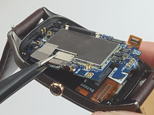

      • Slide the spudger under the gold-plated connection ribbon and lift to disconnect from the motherboard.
    4. Asus ZenWatch 2 Motherboard Replacement: crwdns2935265:04crwdnd2935265:01crwdnd2935265:02crwdne2935265:0 Asus ZenWatch 2 Motherboard Replacement: crwdns2935265:04crwdnd2935265:02crwdnd2935265:02crwdne2935265:0
      • Pull up on the motherboard using tweezers to detach it from the watch.

Step 3 requires three different connectors to be removed from the mainboard. Not one. Attempting to remove the mainboard after only disconnecting the gold-plated connector can result in damaged digitizer/display cable.
