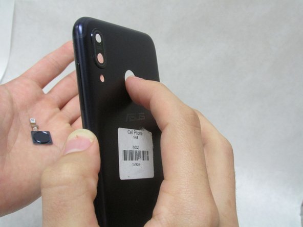

  8. Asus ZenFone 5 Touch Sensor Replacement, Touch Sensor: crwdns2935265:08crwdnd2935265:01crwdnd2935265:02crwdne2935265:0 Asus ZenFone 5 Touch Sensor Replacement, Touch Sensor: crwdns2935265:08crwdnd2935265:02crwdnd2935265:02crwdne2935265:0
    • On the back shell of the phone, push with pressure on the touch sensor until it pops out.
