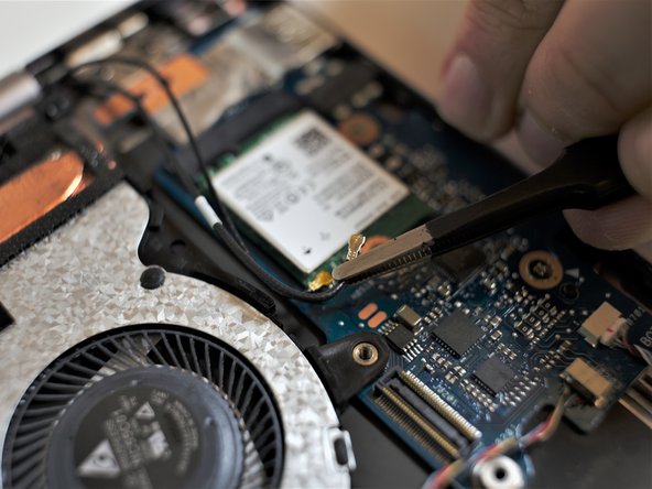

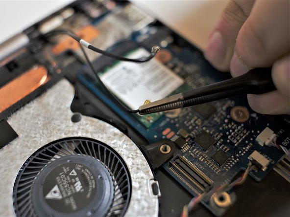

    • Disconnect the two UFL female connector cables by gently prying up with the blunt nose tweezers.
    • Remember which connector was connected to which port. The connector cable with the white strip connects to the port with the white arrow labeled "2".

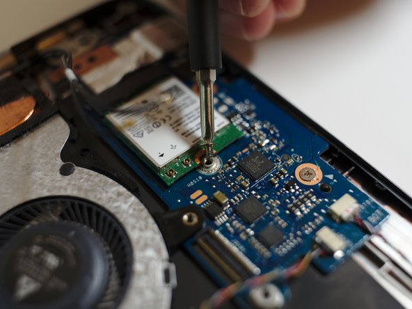

    • Remove the single 2.7 mm screw holding the Wi-Fi adapter using the Philips #0 screwdriver bit.

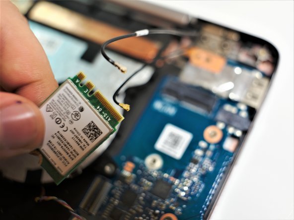

    • Gently grip the Wi-Fi adapter by the sides and pull it out with gentle pressure. You may need to slightly wiggle the adapter to get it to slide out easily.
