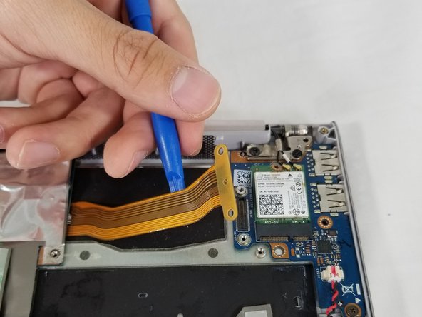

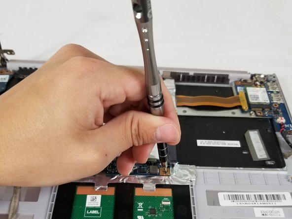

  15. Asus ZenBook UX303U Motherboard Replacement, Motherboard: crwdns2935265:015crwdnd2935265:01crwdnd2935265:02crwdne2935265:0 Asus ZenBook UX303U Motherboard Replacement, Motherboard: crwdns2935265:015crwdnd2935265:02crwdnd2935265:02crwdne2935265:0
    • Remove eleven 4mm Phillips #00 screws.
  16. Asus ZenBook UX303U Motherboard Replacement: crwdns2935265:016crwdnd2935265:01crwdnd2935265:03crwdne2935265:0 Asus ZenBook UX303U Motherboard Replacement: crwdns2935265:016crwdnd2935265:02crwdnd2935265:03crwdne2935265:0 Asus ZenBook UX303U Motherboard Replacement: crwdns2935265:016crwdnd2935265:03crwdnd2935265:03crwdne2935265:0
    • Disconnect all wires connecting the motherboard to the rest of the device.
    • For the two connectors marked in orange, lift the black clip up to release the wire.
    • For the wire marked in yellow, lift it straight up.
  17. Asus ZenBook UX303U Motherboard Replacement: crwdns2935265:017crwdnd2935265:01crwdnd2935265:01crwdne2935265:0
    • Lift and remove the motherboard.
    • Pull the motherboard away from the ports on the side of the device to disconnect them from the computer before lifting the motherboard.
