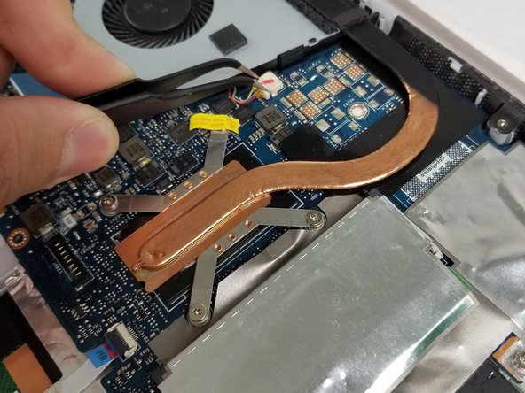

  13. Asus ZenBook UX303U Motherboard Fan Replacement: crwdns2935265:013crwdnd2935265:01crwdnd2935265:03crwdne2935265:0 Asus ZenBook UX303U Motherboard Fan Replacement: crwdns2935265:013crwdnd2935265:02crwdnd2935265:03crwdne2935265:0 Asus ZenBook UX303U Motherboard Fan Replacement: crwdns2935265:013crwdnd2935265:03crwdnd2935265:03crwdne2935265:0
    • Using tweezers, disconnect the cable connector from the motherboard fan.

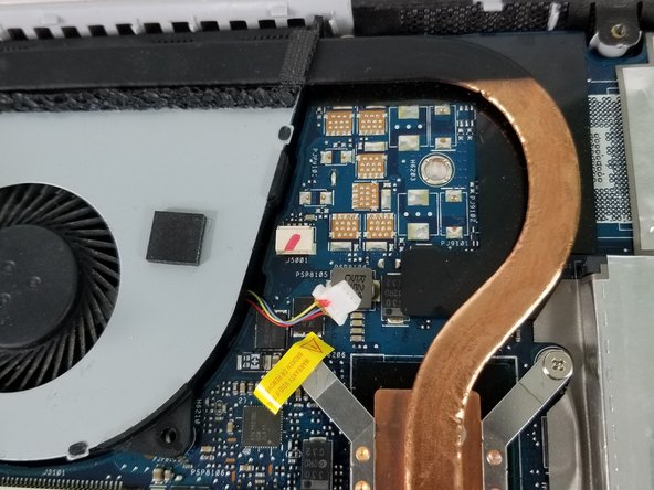

  14. Asus ZenBook UX303U Motherboard Fan Replacement: crwdns2935265:014crwdnd2935265:01crwdnd2935265:02crwdne2935265:0 Asus ZenBook UX303U Motherboard Fan Replacement: crwdns2935265:014crwdnd2935265:02crwdnd2935265:02crwdne2935265:0
    • Lift the fan up and off of the white pegs that secure it into place.
