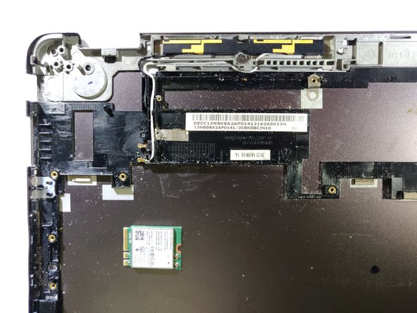

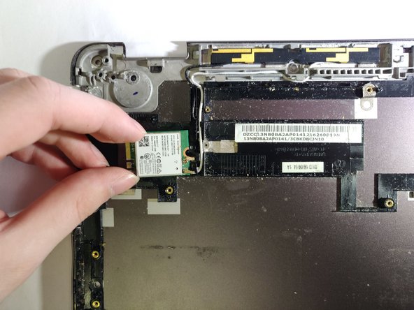

  8. Asus ZenBook Flip UX360C Wi-Fi Wireless Card Replacement, Wi-Fi Wireless Card: crwdns2935265:08crwdnd2935265:01crwdnd2935265:03crwdne2935265:0 Asus ZenBook Flip UX360C Wi-Fi Wireless Card Replacement, Wi-Fi Wireless Card: crwdns2935265:08crwdnd2935265:02crwdnd2935265:03crwdne2935265:0 Asus ZenBook Flip UX360C Wi-Fi Wireless Card Replacement, Wi-Fi Wireless Card: crwdns2935265:08crwdnd2935265:03crwdnd2935265:03crwdne2935265:0
    • Use the metal spudger to remove the chip connections.
    • Gently pull the chip up and to the left to remove it from the device.
