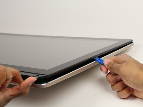

    • Use the plastic opening tool to pry off the black plastic strip at the bottom of the screen by wiggling the tool between the strip and the screen.
    • The strip is held in place with adhesive. You may hear a crackling sound as the strip is peeled off.
    • Run the opening tool slowly along the base of the screen, peeling the black strip back, until the opposite end of the screen is reached.

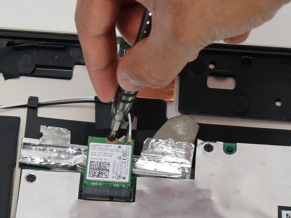

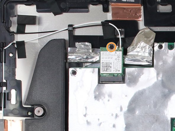

  7. Asus Zen AiO Pro Z240IC Heat Sink Replacement, WiFi (WLAN) Card: crwdns2935265:07crwdnd2935265:01crwdnd2935265:03crwdne2935265:0 Asus Zen AiO Pro Z240IC Heat Sink Replacement, WiFi (WLAN) Card: crwdns2935265:07crwdnd2935265:02crwdnd2935265:03crwdne2935265:0 Asus Zen AiO Pro Z240IC Heat Sink Replacement, WiFi (WLAN) Card: crwdns2935265:07crwdnd2935265:03crwdnd2935265:03crwdne2935265:0
    • Locate the WLAN card in the upper left hand corner of the computer.
    • Use a Phillips #1 screwdriver to remove the 3.2 mm screw on the top of the WLAN card.

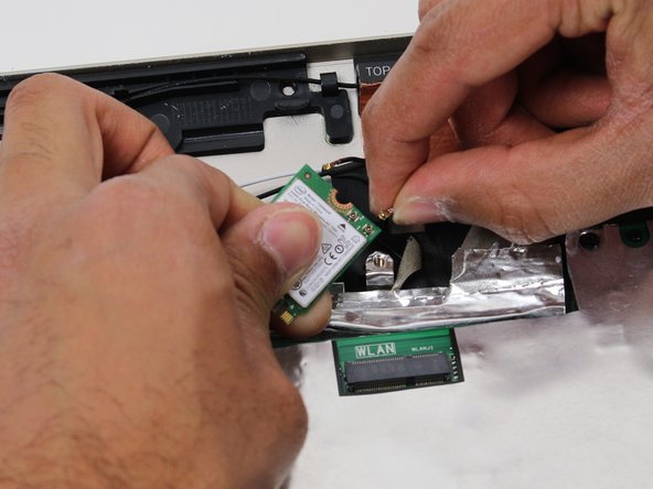

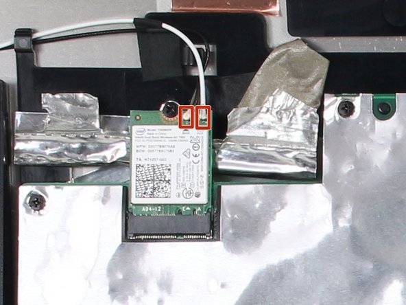

  8. Asus Zen AiO Pro Z240IC Heat Sink Replacement: crwdns2935265:08crwdnd2935265:01crwdnd2935265:03crwdne2935265:0 Asus Zen AiO Pro Z240IC Heat Sink Replacement: crwdns2935265:08crwdnd2935265:02crwdnd2935265:03crwdne2935265:0 Asus Zen AiO Pro Z240IC Heat Sink Replacement: crwdns2935265:08crwdnd2935265:03crwdnd2935265:03crwdne2935265:0
    • Pull out the WLAN card from its socket.
    • Remove the two antennae wires from the WLAN card by pulling up on the coaxial connectors.

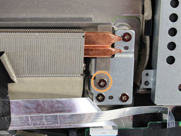

    • Use a Phillips #1 screwdriver to remove the one (1) 4.8 mm screw directly below the copper heat sink channel.

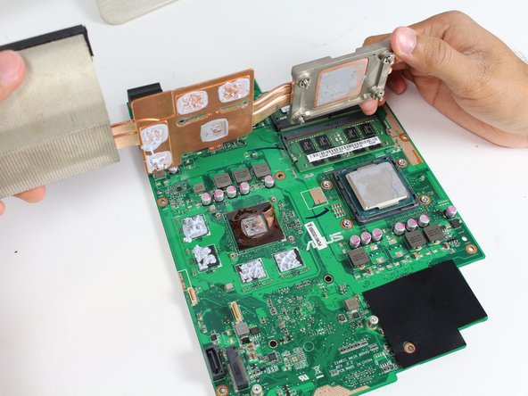

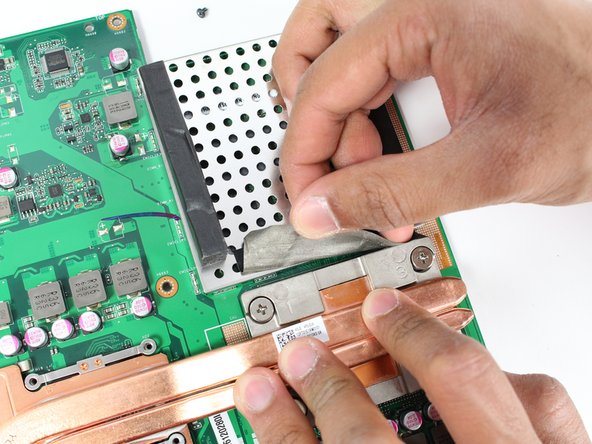

  15. Asus Zen AiO Pro Z240IC Heat Sink Replacement, Heat Sink: crwdns2935265:015crwdnd2935265:01crwdnd2935265:02crwdne2935265:0 Asus Zen AiO Pro Z240IC Heat Sink Replacement, Heat Sink: crwdns2935265:015crwdnd2935265:02crwdnd2935265:02crwdne2935265:0
    • Use a Phillips #1 screwdriver to loosen the four (4) large silver screws evenly in the order of the numbers engraved next to each screw.
    • Use a Phillips # 0 to loosen the other four (4) 2.4 mm screws evenly in the order engraved on the copper next to each screw.
    • Repeat the last two bullets until all the larger silver screws make a clicking sound and the 2mm screws are removed.
    • The silver screws cannot be completely removed.
    • Peel away the black tape between the RAM shield and the heat sink.
    • When reattaching the heat sink to the motherboard, make sure to tighten the screws a little bit at a time, in the same order as before, until they are all snug.
  16. Asus Zen AiO Pro Z240IC Heat Sink Replacement: crwdns2935265:016crwdnd2935265:01crwdnd2935265:02crwdne2935265:0 Asus Zen AiO Pro Z240IC Heat Sink Replacement: crwdns2935265:016crwdnd2935265:02crwdnd2935265:02crwdne2935265:0
    • Remove the heat sink by lifting up.
    • During reassembly, make sure to use a fresh application of thermal paste. Refer to the following guide: How to Apply Thermal Paste
