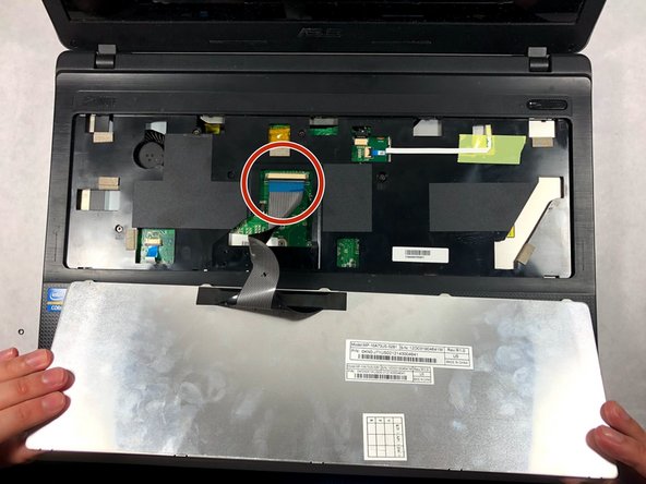

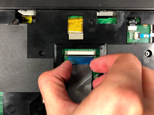

  3. Asus Z54C-JS31 Optical Disc Drive Replacement: crwdns2935265:03crwdnd2935265:01crwdnd2935265:03crwdne2935265:0 Asus Z54C-JS31 Optical Disc Drive Replacement: crwdns2935265:03crwdnd2935265:02crwdnd2935265:03crwdne2935265:0 Asus Z54C-JS31 Optical Disc Drive Replacement: crwdns2935265:03crwdnd2935265:03crwdnd2935265:03crwdne2935265:0
    • Once the keyboard is free, disconnect the ribbon cable from the zero insertion force (ZIF) connector by flipping up the locking flap and pulling the cable out.

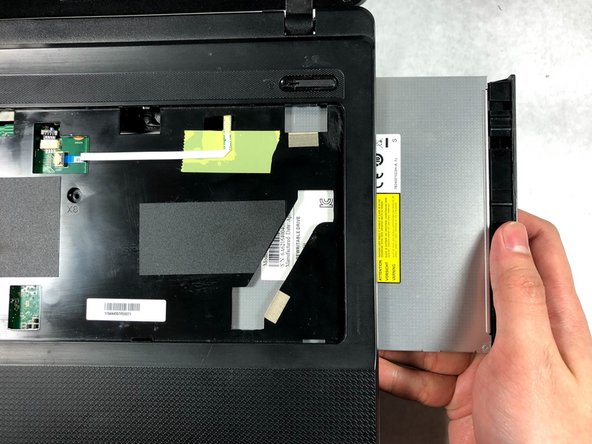

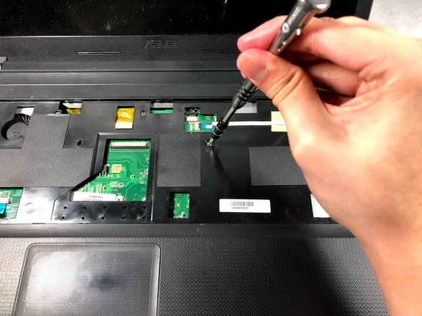

  4. Asus Z54C-JS31 Optical Disc Drive Replacement, Optical Disc Drive: crwdns2935265:04crwdnd2935265:01crwdnd2935265:03crwdne2935265:0 Asus Z54C-JS31 Optical Disc Drive Replacement, Optical Disc Drive: crwdns2935265:04crwdnd2935265:02crwdnd2935265:03crwdne2935265:0 Asus Z54C-JS31 Optical Disc Drive Replacement, Optical Disc Drive: crwdns2935265:04crwdnd2935265:03crwdnd2935265:03crwdne2935265:0
    • Remove the 3mm screw with a Phillips #000 screwdriver.
    • Slide out the optical disc drive by pulling it away from the laptop.
