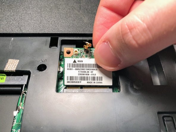

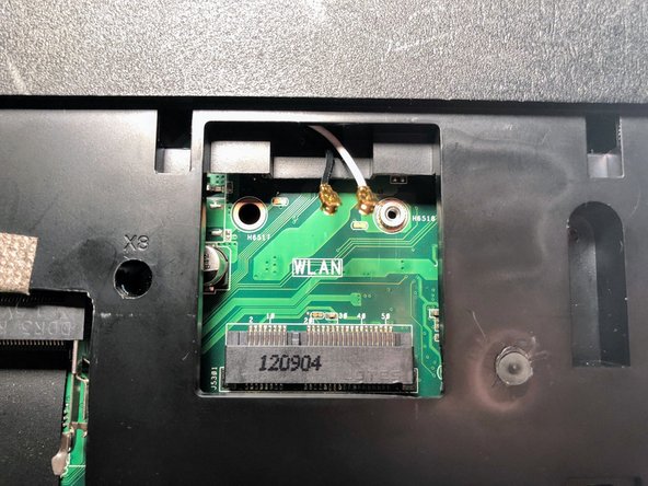

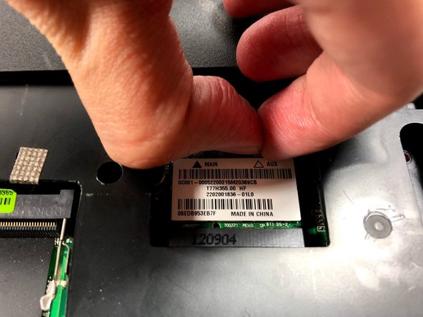

  6. Asus Z54C-JS31 Motherboard Replacement, WiFi Card: crwdns2935265:06crwdnd2935265:01crwdnd2935265:03crwdne2935265:0 Asus Z54C-JS31 Motherboard Replacement, WiFi Card: crwdns2935265:06crwdnd2935265:02crwdnd2935265:03crwdne2935265:0 Asus Z54C-JS31 Motherboard Replacement, WiFi Card: crwdns2935265:06crwdnd2935265:03crwdnd2935265:03crwdne2935265:0
    • Disconnect both the black and white coaxial connectors from the WiFi card by pulling up on the gold colored piece.
  7. Asus Z54C-JS31 Motherboard Replacement: crwdns2935265:07crwdnd2935265:01crwdnd2935265:03crwdne2935265:0 Asus Z54C-JS31 Motherboard Replacement: crwdns2935265:07crwdnd2935265:02crwdnd2935265:03crwdne2935265:0 Asus Z54C-JS31 Motherboard Replacement: crwdns2935265:07crwdnd2935265:03crwdnd2935265:03crwdne2935265:0
    • Remove the 3mm screw from the top right corner of the WiFi card using a Phillips #0 screwdriver.
    • The WiFi card will pop up. Grasp it and pull it out of its slot.

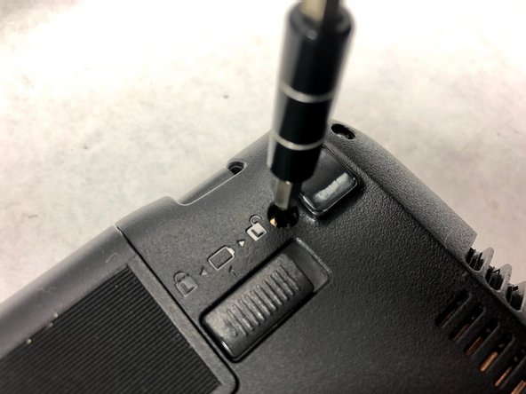

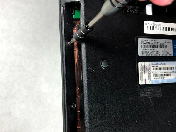

    • Turn the laptop over so that the back side is facing up.
    • Remove eight 9mm screws from the back of the laptop.
    • Remove two 6mm screws near the battery.
    • Remove two 3mm screws from the optical drive slot.

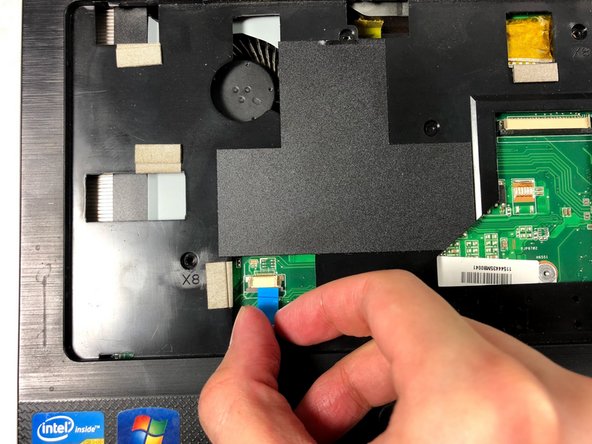

  14. Asus Z54C-JS31 Motherboard Replacement: crwdns2935265:014crwdnd2935265:01crwdnd2935265:02crwdne2935265:0 Asus Z54C-JS31 Motherboard Replacement: crwdns2935265:014crwdnd2935265:02crwdnd2935265:02crwdne2935265:0
    • Disconnect the two ribbon cables from the no-fuss ribbon cable connectors attached to the motherboard by pulling the cable straight out of the connector.
    • Disconnect the ribbon cable from the zero insertion force connector by flipping up the locking flap and pulling the cable out.

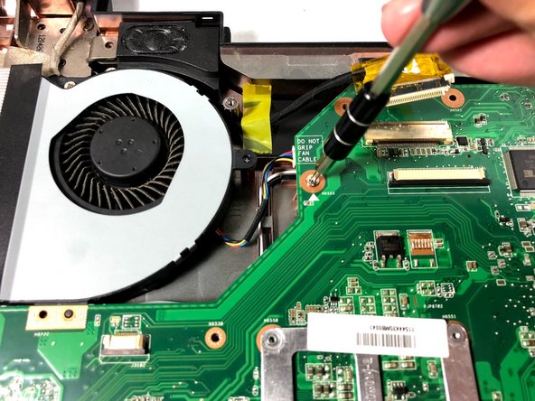

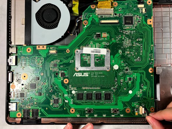

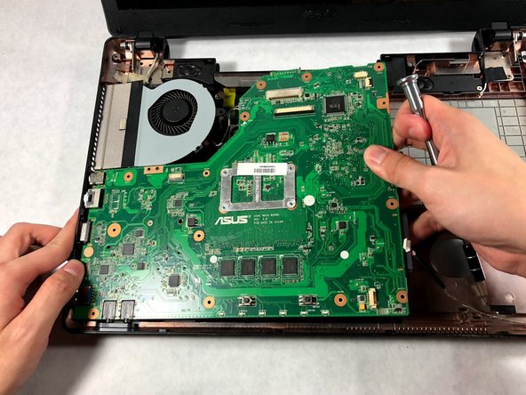

  15. Asus Z54C-JS31 Motherboard Replacement: crwdns2935265:015crwdnd2935265:01crwdnd2935265:03crwdne2935265:0 Asus Z54C-JS31 Motherboard Replacement: crwdns2935265:015crwdnd2935265:02crwdnd2935265:03crwdne2935265:0 Asus Z54C-JS31 Motherboard Replacement: crwdns2935265:015crwdnd2935265:03crwdnd2935265:03crwdne2935265:0
    • Remove the two 5mm screws holding the motherboard and fan in place.
    • Lift out the motherboard and fan.
