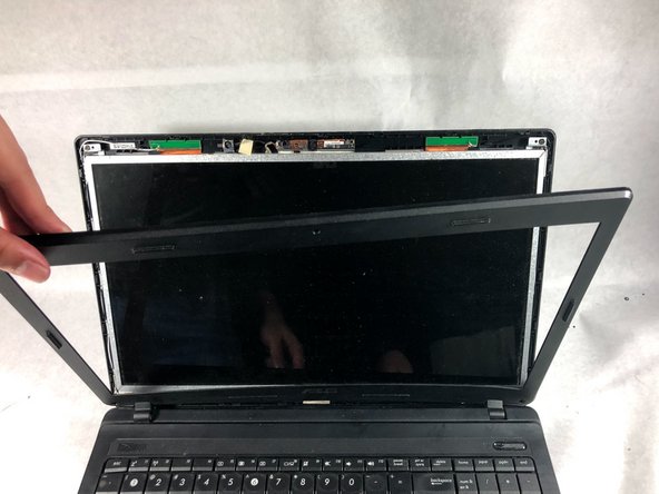

  3. Asus Z54C-JS31 Display Replacement: crwdns2935265:03crwdnd2935265:01crwdnd2935265:02crwdne2935265:0 Asus Z54C-JS31 Display Replacement: crwdns2935265:03crwdnd2935265:02crwdnd2935265:02crwdne2935265:0
    • Use the plastic opening tool to pop off the plastic border around the display.

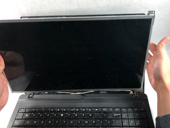

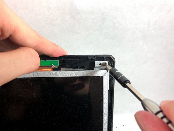

  4. Asus Z54C-JS31 Display Replacement: crwdns2935265:04crwdnd2935265:01crwdnd2935265:03crwdne2935265:0 Asus Z54C-JS31 Display Replacement: crwdns2935265:04crwdnd2935265:02crwdnd2935265:03crwdne2935265:0 Asus Z54C-JS31 Display Replacement: crwdns2935265:04crwdnd2935265:03crwdnd2935265:03crwdne2935265:0
    • Remove the two 9mm screws from the top corners of the display with a Phillips #000 screwdriver.
    • Carefully lift the display out and place the screen face down on the keyboard.
  5. Asus Z54C-JS31 Display Replacement: crwdns2935265:05crwdnd2935265:01crwdnd2935265:01crwdne2935265:0
    • Disconnect the display cable connector attached to the display.
