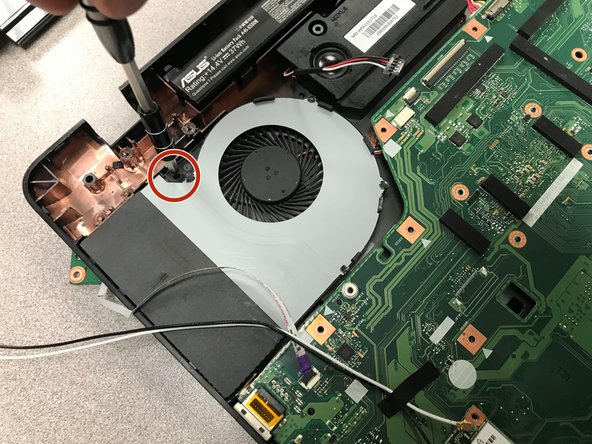

    • Remove the two screws directly above the fan.
