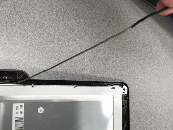

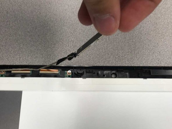

    • Slowly pull up the webcam out of its slot, and begin to remove the wire.
  8. Asus X751MA-DH01TQ  Web Cam Replacement: crwdns2935265:08crwdnd2935265:01crwdnd2935265:02crwdne2935265:0 Asus X751MA-DH01TQ  Web Cam Replacement: crwdns2935265:08crwdnd2935265:02crwdnd2935265:02crwdne2935265:0
    • Continue to unravel the wire and peel the webcam wire sticker off.
  9. Asus X751MA-DH01TQ  Web Cam Replacement: crwdns2935265:09crwdnd2935265:01crwdnd2935265:02crwdne2935265:0 Asus X751MA-DH01TQ  Web Cam Replacement: crwdns2935265:09crwdnd2935265:02crwdnd2935265:02crwdne2935265:0
    • Once the sticker is peeled off pull the plug holding the webcam into the circuit board and the webcam is now disconnected.
