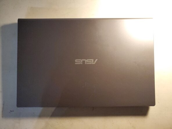

    • Power the laptop down and unplug all of the cables.
    • Flip over the laptop.

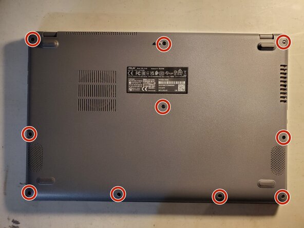

  2. Asus X515 Wifi Card Replacement, Take off bottom cover: crwdns2935265:02crwdnd2935265:01crwdnd2935265:02crwdne2935265:0 Asus X515 Wifi Card Replacement, Take off bottom cover: crwdns2935265:02crwdnd2935265:02crwdnd2935265:02crwdne2935265:0
    • Remove the 10 phillips screws from the bottom of the case.
    • Using a prying tool pry the bottom of the case open.
