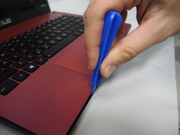

    • Pry open computer using plastic opening tool. You will be separating the keyboard from the back of the computer.
    • Do not completely separate the keyboard and back of the laptop. There are ribbon cables that need to be disconnected first.
    • When reassembling, you will hear snapping noise as you press the keyboard and back of the computer together.
