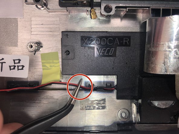

    • Use the tweezers to free the speaker from the plastic clips.
    • Use a finger to lift the speaker and break the bond between the adhesive on the base plate and the speaker.

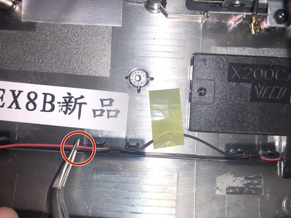

    • Use the tweezers to carefully lift the wires from the plastic clips.

    • Use the metal tweezers to free the speaker from the plastic clips.
    • Use the metal spudger to break the bond between the base plate adhesive and the speaker.
    • Lift the speakers and remove them from the base plate.
